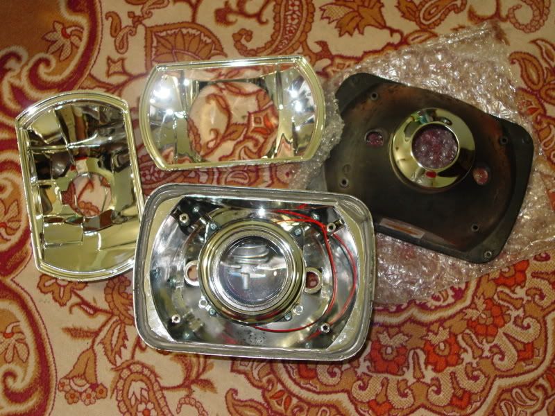

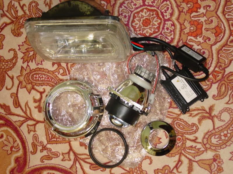

HL Housing, Projector, Ballast, Chrome mounting disk, Apollo Shroud, and Shroud Centric Ring. Apollo Shroud and Shroud Centric ring are not use because it's too big for the HL housing.

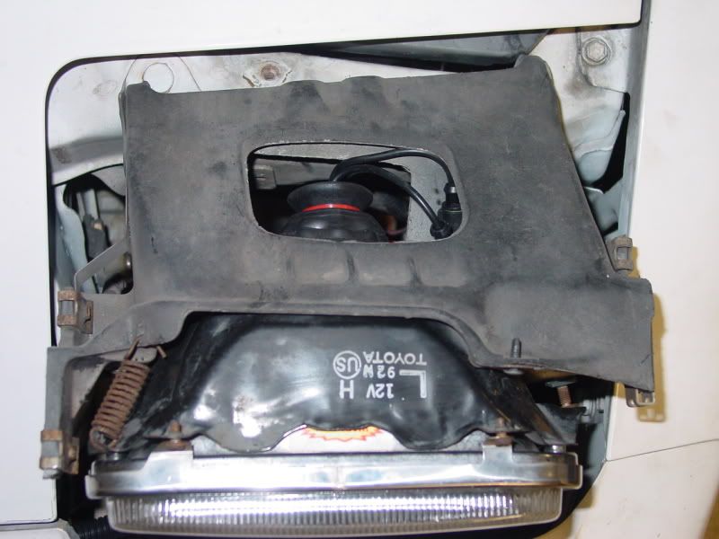

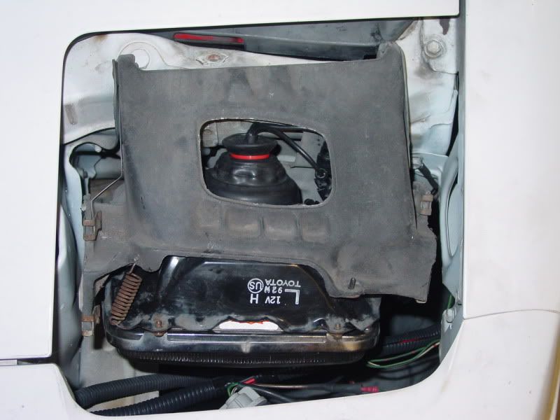

HL Housing from behind.

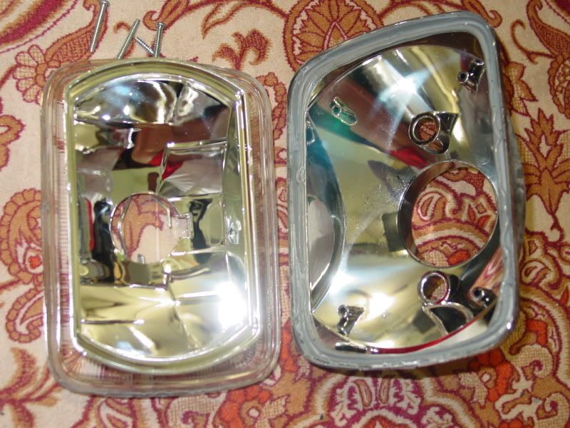

Heat oven to 300F turn OFF, bake for 8-10 minutes and this is what it look like.
This particular housing also have a reflector bow inside. There are 2 holes for "city light"
---------- Post added at 09:54 AM ---------- Previous post was at 09:52 AM ----------
I have to grind down the 2 "city light" holes for the projector screw to "sit" on. The HL housing has a 3" opening on the back so I don't have to do any cutting on the housing.
Test fit the projector using 1.5" lavatory chrome pipe cover.
Have to cut the reflector bow.
Test fit with the "Bath Shroud" ;)

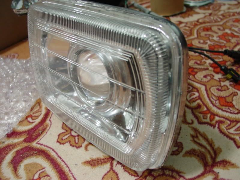

Put it all together
Using original boot cover from the light housing.

In the car. Again, there is no modification to the HL mounting assembly.
Head light UP (looking down)
Headlight DOWN (looking down)
Headlight DOWN (looking in front)
Wires/cables are all clear from retractable mechanism. ;)

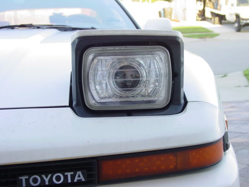

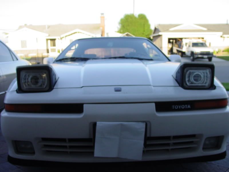

Completed.
Light not ON
Is it getting dark here? :)
In driver seat wall shot
Out driver door wall shot

OK D2S bulb with D2S to AMP adapter (for aftermarket ballast), will NOT fit without any modification. I did test fit it before buying D2H bulb. With the HL up, it fit just fine. With the HL down, the bulky adapter to the bulb will HIT the radiator support bracket. To use D2S bulb, I have to cut/bend the radiator support bracket or push the HL/projector about 1/2 inch toward the front to clear when the HL going down.
Originally, I bought D2S bulb + adapter + ballast from DDM. It doesn't fit, so I came back and exchange for a H1 setup instead of DS2 setup, they refund me the different (D2S cost 15 more because of the adapter). I talk to Matt at TRS and he inform me that D2H setup is about 1/2 inch shorter than D2S setup. So I went and order D2H. Otherwise I would of exchange the Mini D2S to Mini H1. Now I have an extra set of H1 bulb collecting dust.
I ran into the same clearance issue on my setup. I used 1/2" spacers to move the HL assembly forward & that fixed the issue w/o cutting the support.
Looking at your pic for reference You can see by using 1/2" spacers at each HL mounting point will not have any clearance issues in front either.
