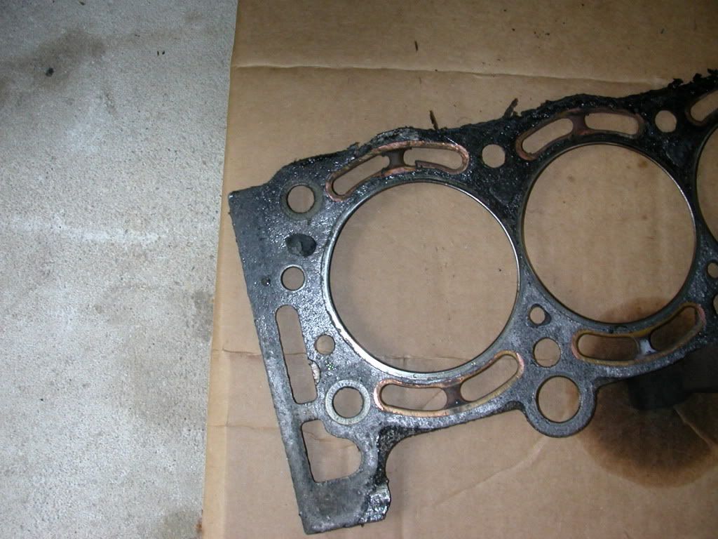

now the #1 solenoid is bad in the trans and the head-gasket is blown
so the plan is to pull the head get it machined and replace valve seals and check clearances and new Toyota head gasket with arp bolts

Are you going to have the block decked? Cause i don't think the MHG will seal if it isn't....other then that, ARP hardware all the way around, and a good quality torque bar, will be your best friend in the long run. Make sure your turbo checks out too cause they get cranky with anything other then stock boost.

no im going with a toyota headgaskit wanted to rebuild but dont have the cash right now..

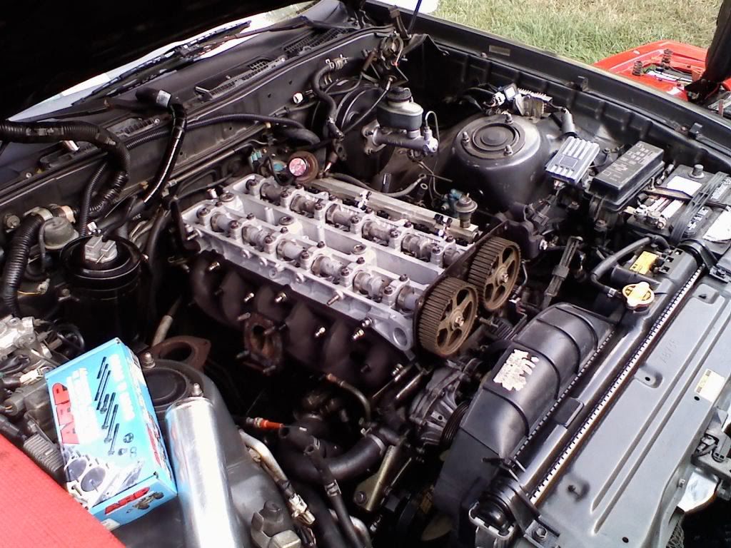

ok heres the update worked on it for a few hours on saturday got everything done on intake side wire harness all unhooked... tonight finally got the turbo off hopeing to have the head off by tomorow
this is my first major car repair ive owned two mk3's so far this one being turbo and had a ruff life
will post pics of engine and turbo tomorow

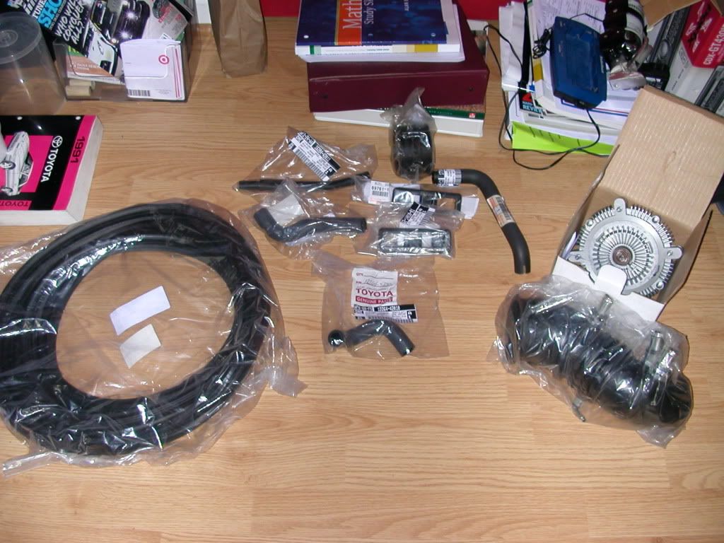

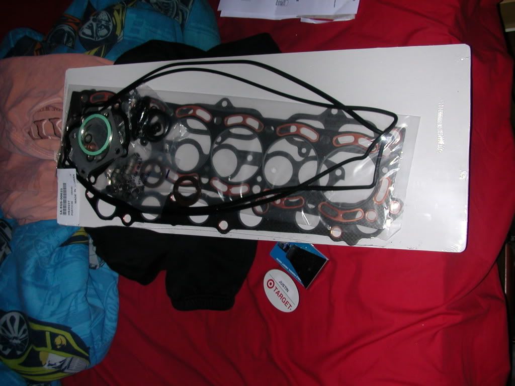

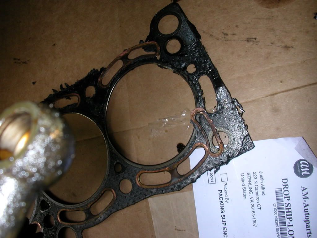

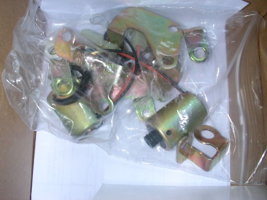

for now heres what the fedex droped off today
turbo rebuild kit
headgasket kit no i do not plan on useing the headgaskit from this kit...toyota all the way on that.
new shift solenoids number one is bad in my trans

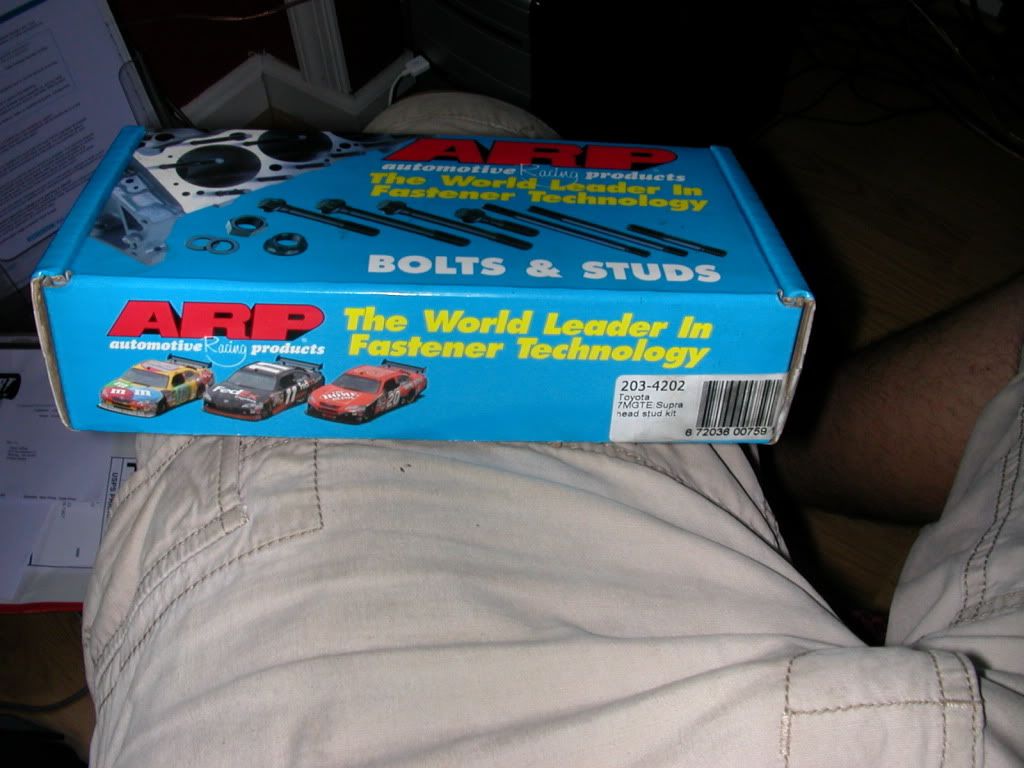

ARP bolts (box says studs bought used)
prosport water temp gauge looks great cant wait to see how it performance

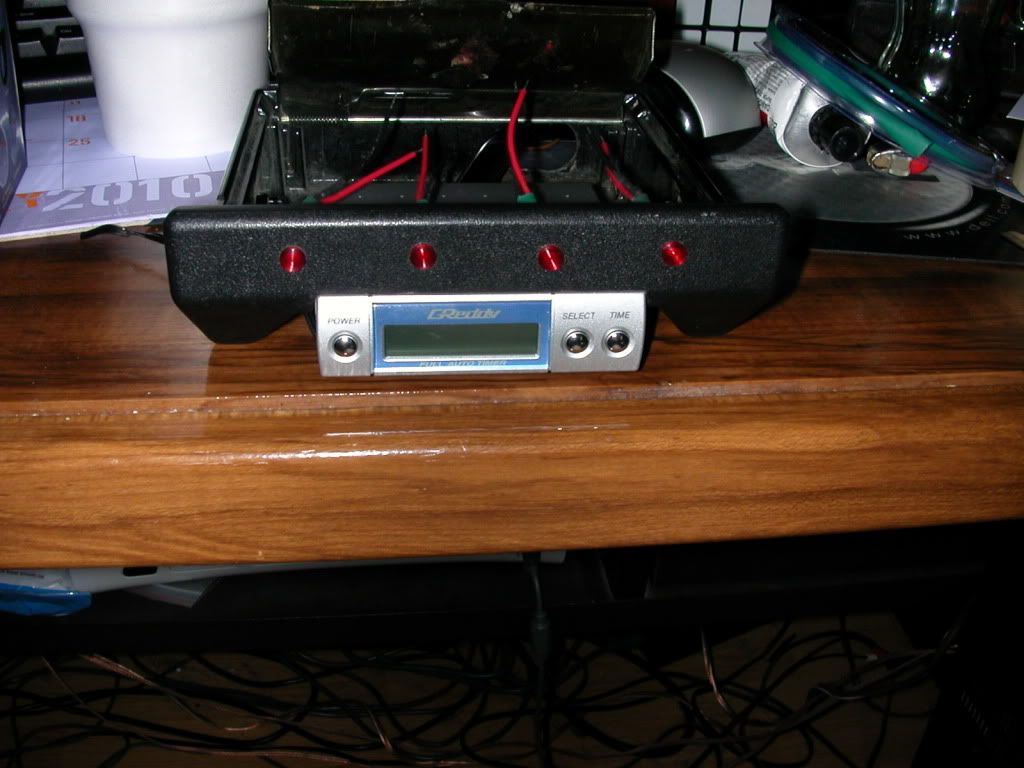

and my ash tray turbo timer installed and four LED lights for my AWshifting push butten shifting kit

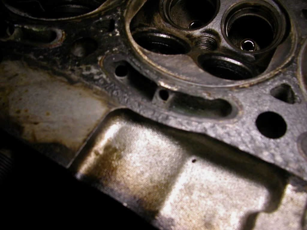

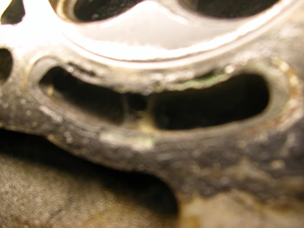

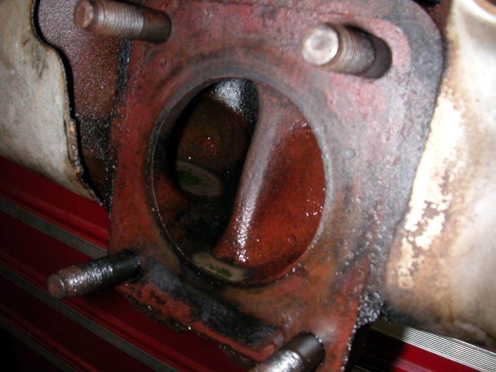

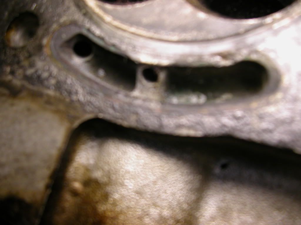

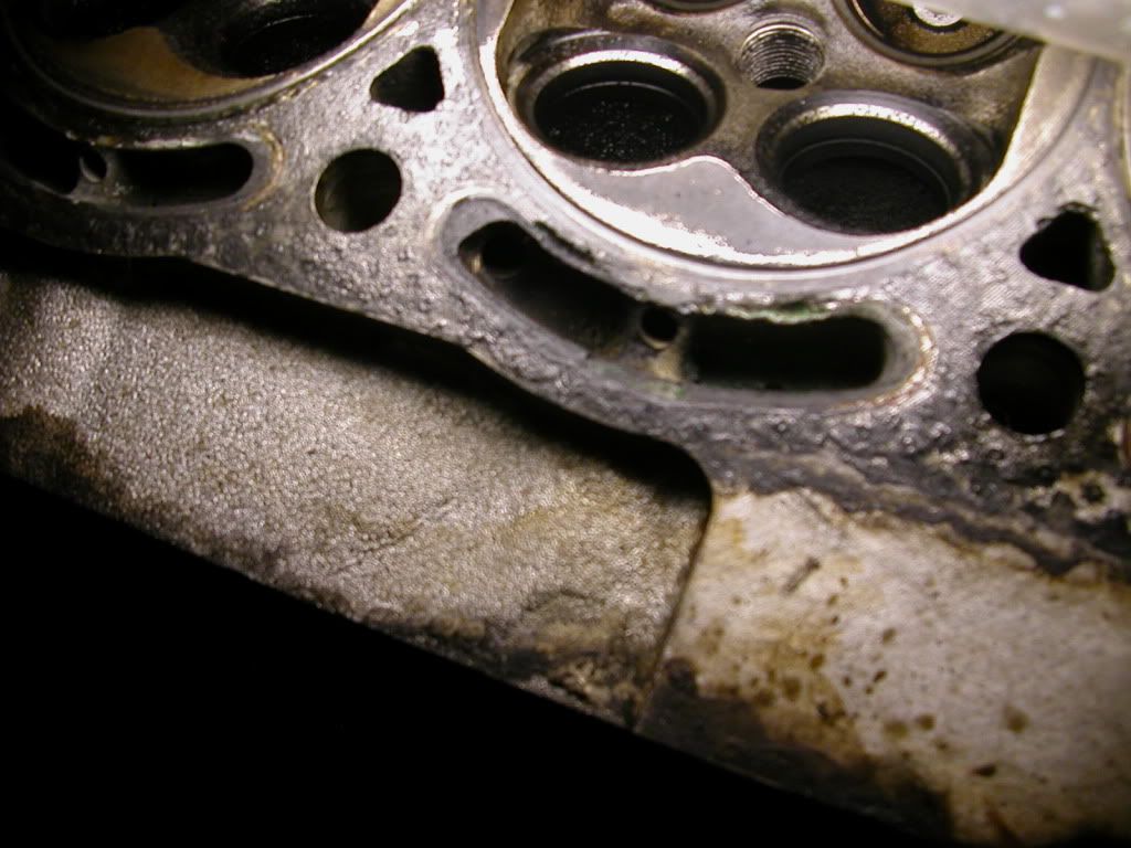

head is kinda scary looking have a thread under 7mgte tech if you guys have any advice

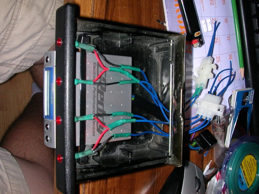

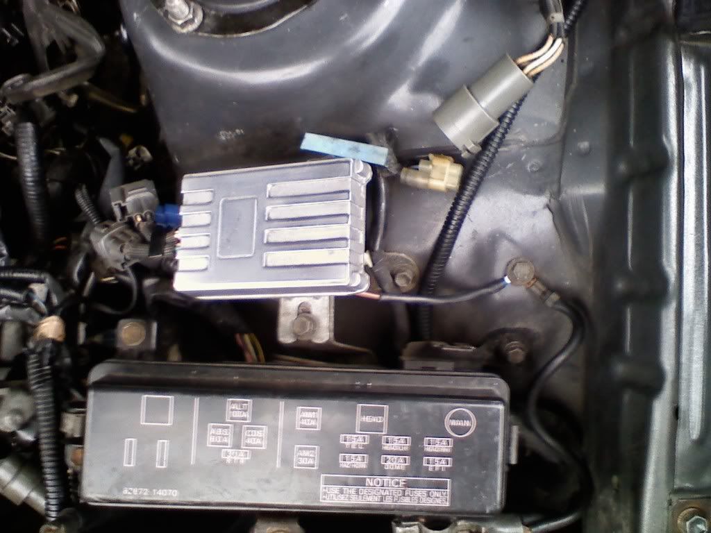

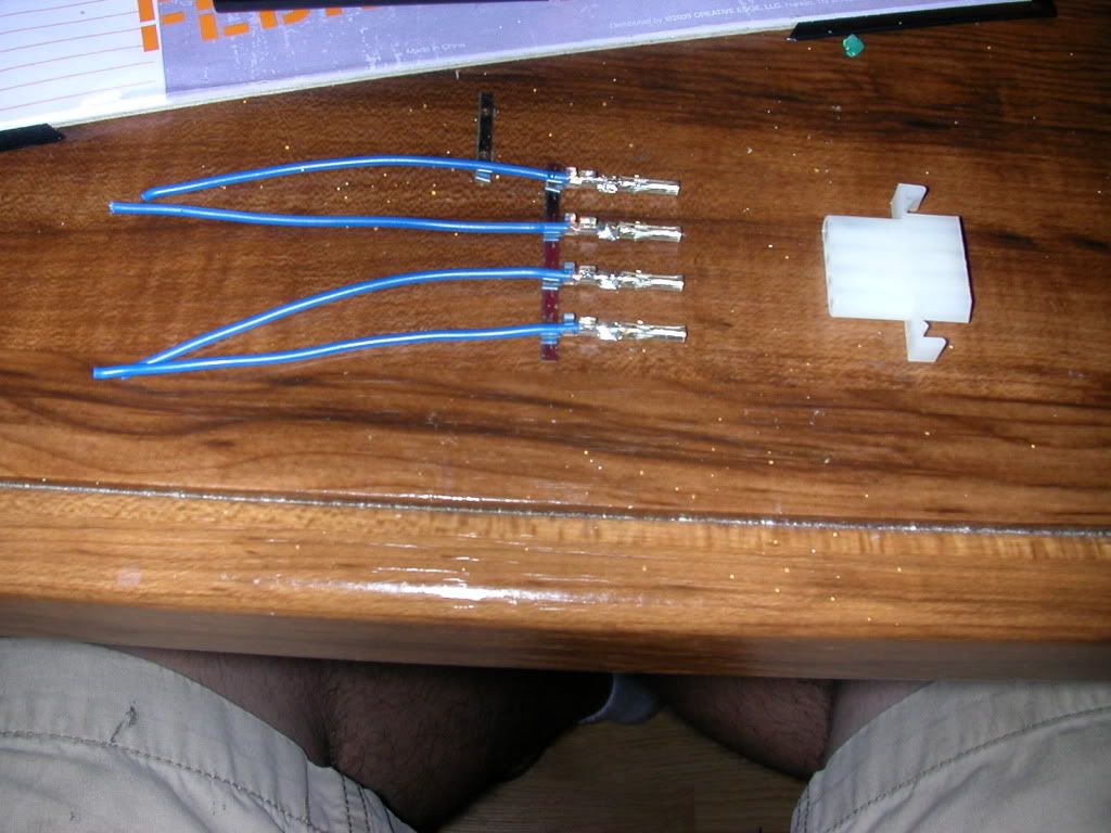

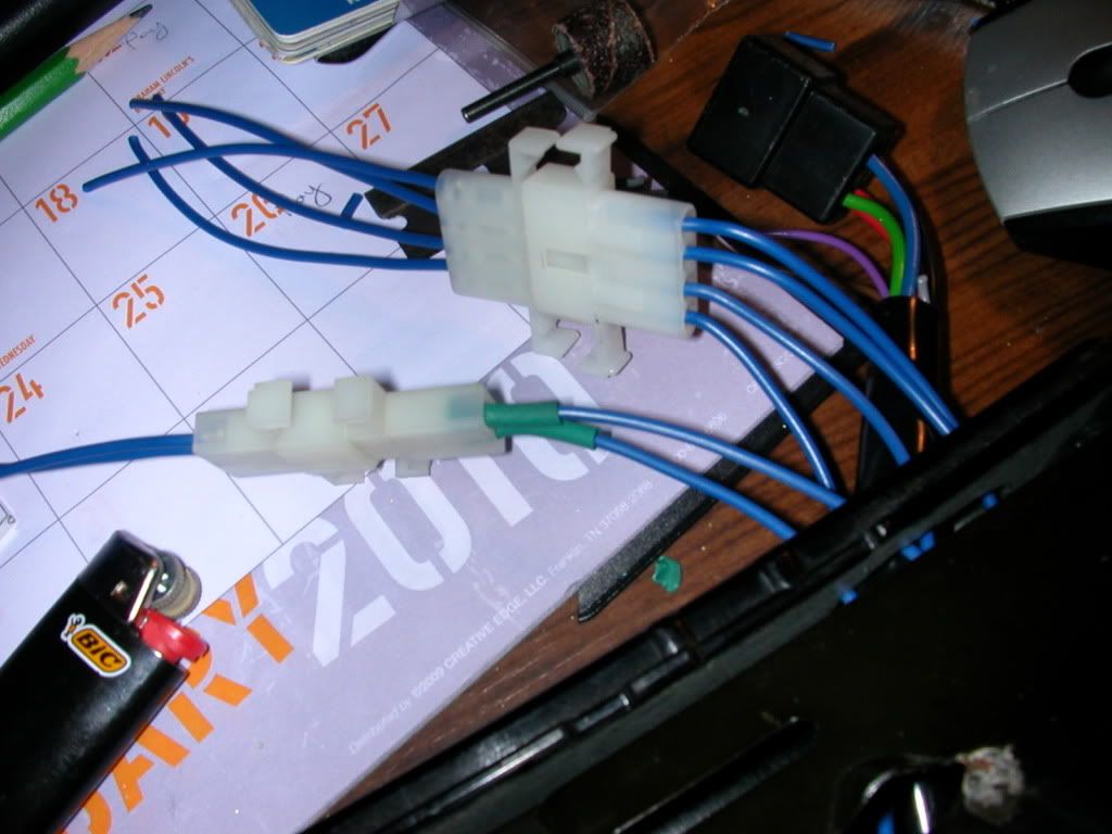

more pics of my pretty professional wiring im pretty pleased with it

Thanks update is
talked to my machinest today and he can fix the head 150 bucks to fix the coolent passages and then 75 to resurface
his done several 7m heads the way he is going to do it... heating the head up and welding the coolent pasages
also got my cps rebuild kit today started by geting the gear off ground off the head a little bit and drove it out suporting it underneath with a 8mm socket worked great gonna finish it tomorow got my second sawblade striped and machine lines sanded out now just gotta polish it

heres the update so far ordered a new pigtail for the cps cause the one thats on it is split
2nd
head is unrepairable it has already had 21thousands takin off of it

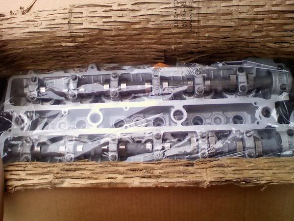

she runs guys sorry ive been so diligently working on the car really havent thought of posting pics... i ended up buying that head on the link on the first page 400 bucks beautiful work mirror finish on the surface exhaust already helicoiled trqd down to 85 foot pounds gonna do the retorqe at the end of the week my ? is should i go in the order of the book and one at a time break it loss and retrq it or just put the wrench on it and make sure its 85 ftibs? gonna throw a few pics up

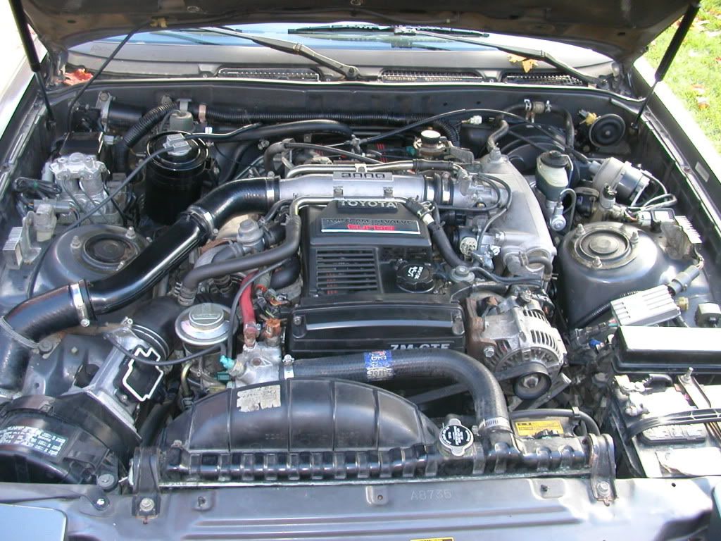

heres a teaser pic
thanks for the tip too
have more pics tomorow can find my cord for my phone too hook to my comp

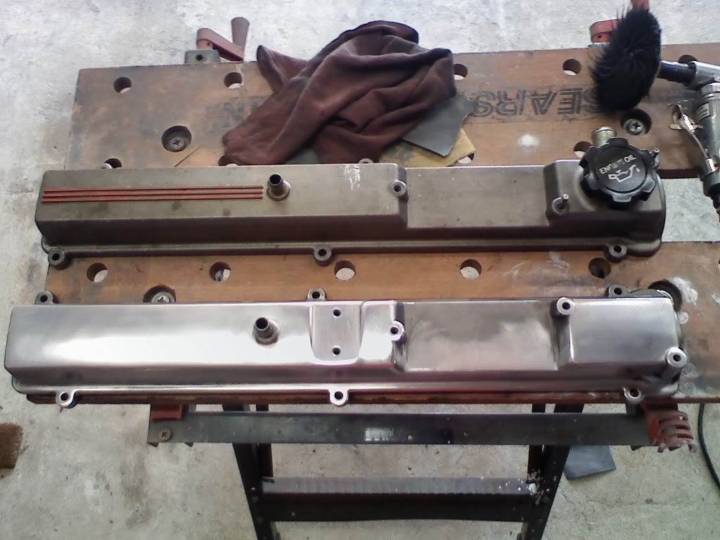

polished and regrounded

polished vrs unpolished

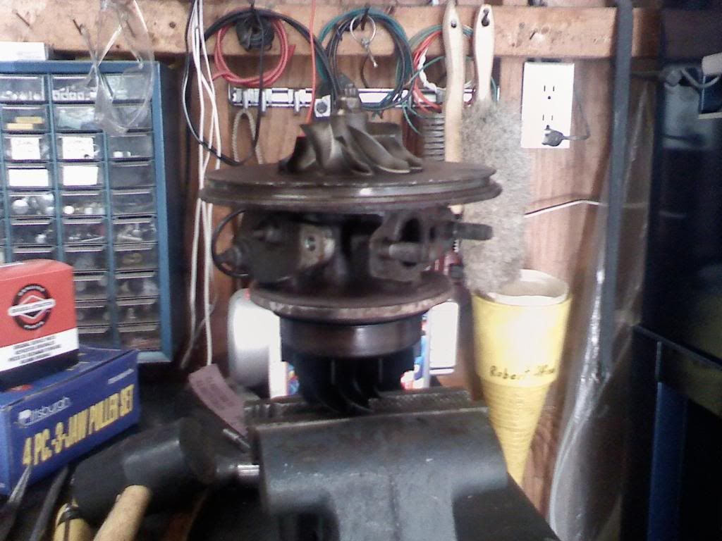

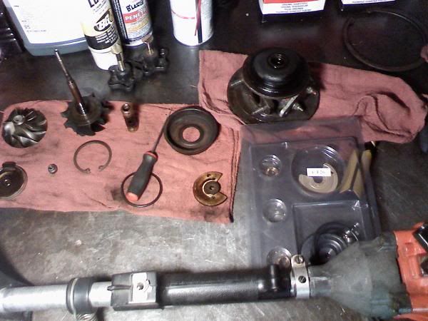

turbo being taken apart for rebuild
turbo completely striped and btw anyone who wants to try to put new oil seals in one its pie i mean pie!

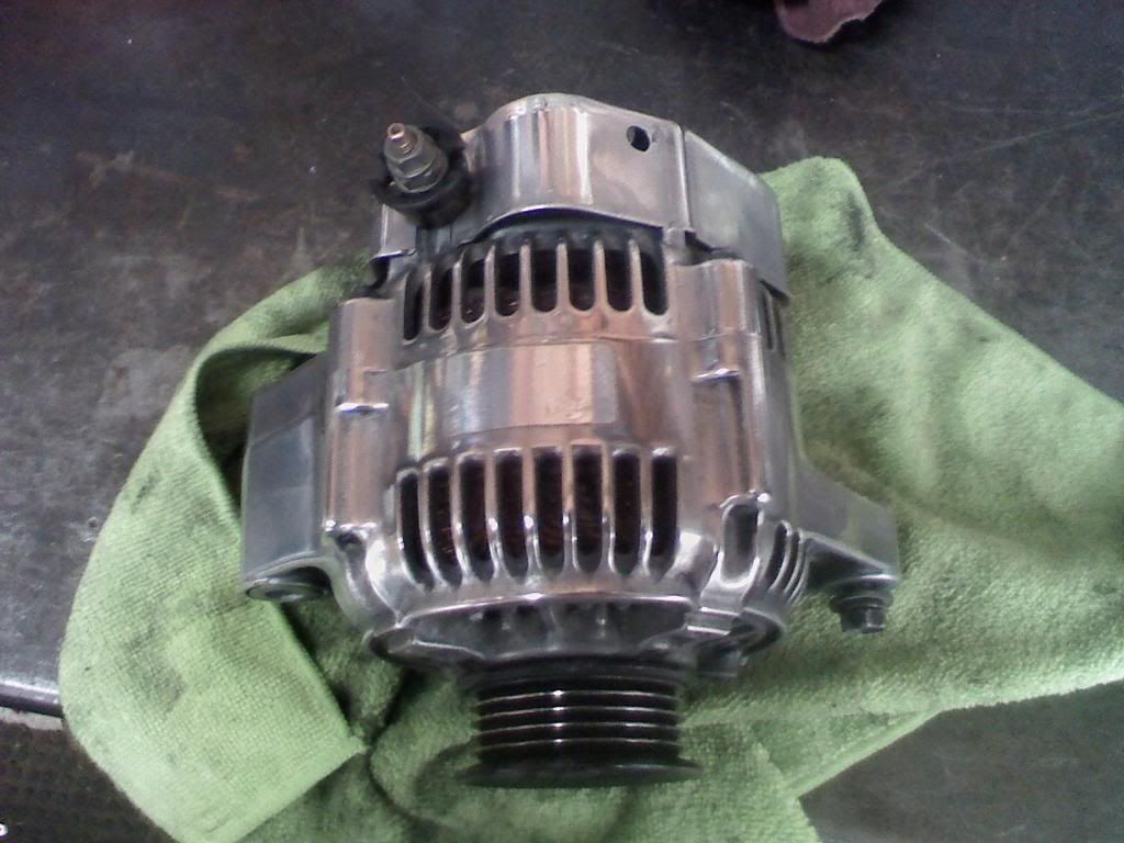

polished alternator
head when i first opened the box but i can tell you this guy does great work dont have anymore pics of the head but the surface was mirror and the exhaust was helicoiled and everything simply bolt it on the cams are mirror no scars my old head taped when it was idleing cause of the scaring on the cams but this one the only thing u here is the injectors clicking and my blown powersteering pump lol
