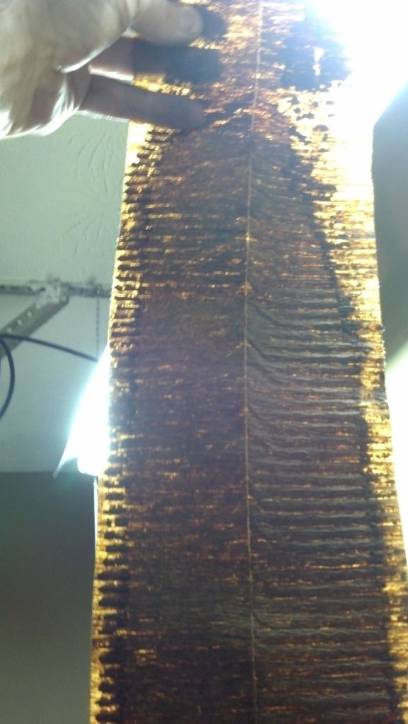

That filter had definitely seen better days! I think my car had the fuel filter changed right before I got the car because it was super shiny and new looking, but if I do replace the fuel pump I would most likely replace the filter as well just for peace of mind.

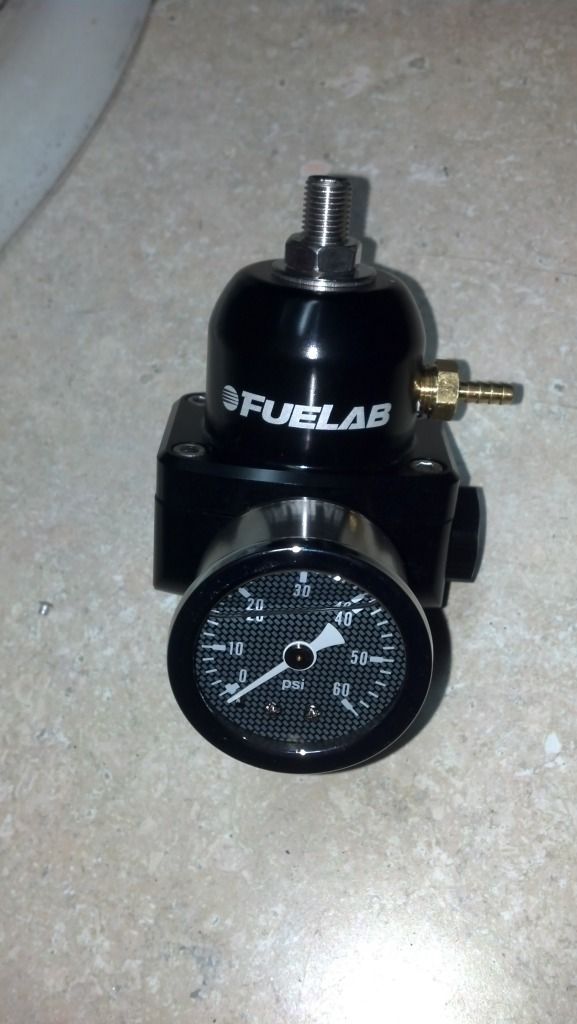

My car has a long initial crank time, but not just when it's hot. I suspect my cheap Ebay fuel pressure regulator, so I bought this to install this week.
