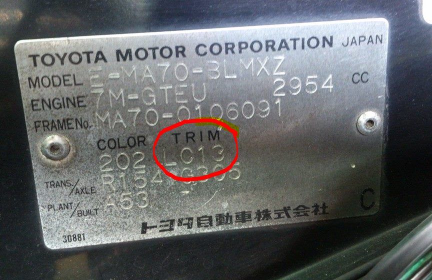

Just realised that I had previously saved pictures of your interior as a reference for my build. They came up in a google image search :)
Do you mind me asking your interior trim code? Interested if it's Lx32 or Lx33
