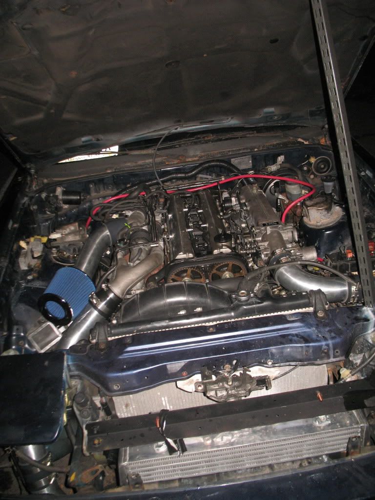

well it was the first nice night since I broke in my clutch so I decided to do a quick pull on the highway to see how she pulls. Anyway, im in third and im pulling up untill 5k or so then i hear a loud POP, almost like a IC pipe popped off. Instead, the car died and I coasted the the side of the road. The car would not start again, it cranks and cranks and cranks but no start. With the throttle open, the car was able to chug a couple of times but thats the best it did. Anyone have any ideas on what it can be? Ill be pulling codes tomorrow. Any ideas on where to start looking?
Edit, I found this
Code 78 Fuel pump control signal fault
is that because I have my pump on a switch? and could this cause my car to die and not start?
Well timing is in check, pulled my plugs and they were a little dark for 500 miles. I changed out the ECU and did a ground check. No luck.
Something that struck my mind, The crank trigger wheel(sprocket looking thing) came off when the engine was out on the stand, but I heated it up and pressed it back on there. Maybe the crank trigger was not on straight enough and bringing it the upper RPM's brought it to the max and caused it to fall off again? just a though. Ill have pics/videos up soon
