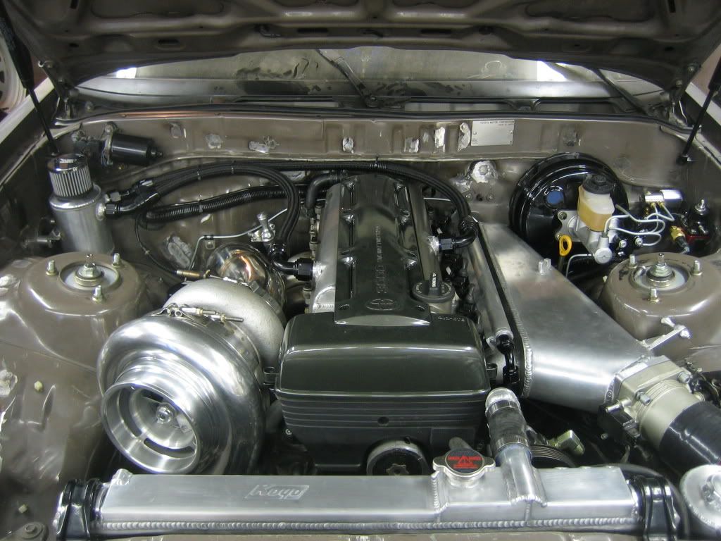

hvyman
Dang Dude! No Way Man.
Apr 17, 2007
12,568
Fullerton,CA
Is it a 2jzgte or ge?
And are those black ss hoses or braided nylon? What are you using for the turbo drain and feed? teflon hoseS?
Sick build and ya massive turbo.
Janz99
Jun 6, 2008
234
Winnipeg, Manitoba
Built GE, braided nylon hoses up top. Oil feed and drain are braided stainless. The drain line has a heat sheathing over it to protect it from the header. Feed is Teflon, braided stainless.
