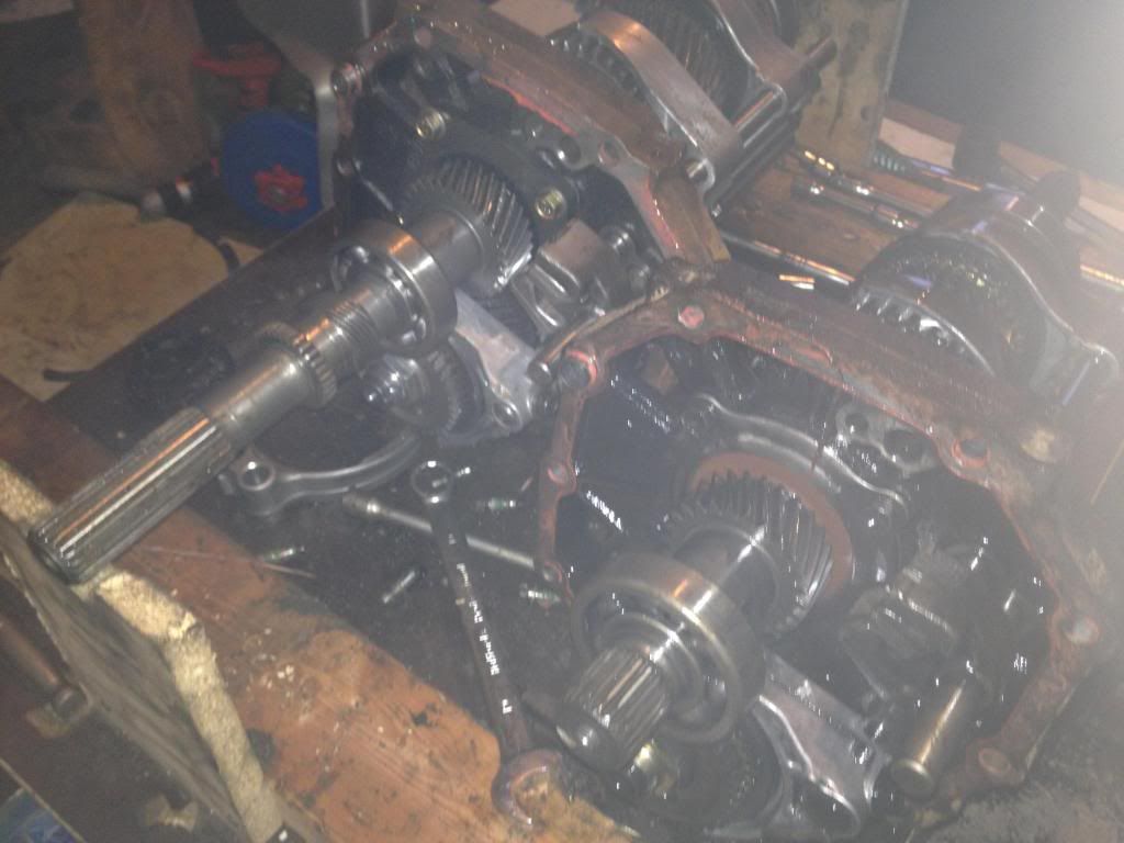

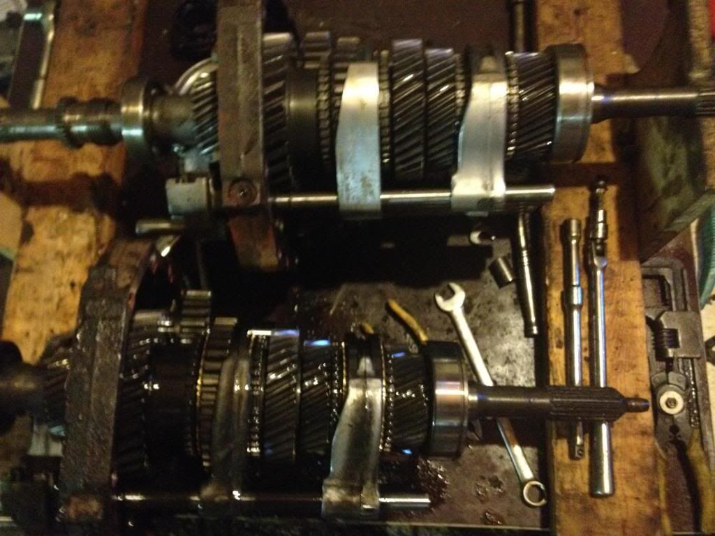

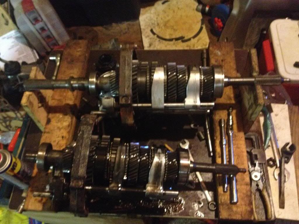

I decided to Hybrid an R154 with an R150F
Here are the two transmissions beside eachother
I rebuilt them using the Supra (R154) Input shaft, counter shaft and gears so I could use the R154 bellhousing.
THe output shaft was from the R150F and I had the supra gears pressed onto it. Unfortunately I am stuck with the Chain case for now but shouldnt be an issue untill I start abusing it...oh and get a front drive shaft lol
ANYWAY
All new synchros and bearings

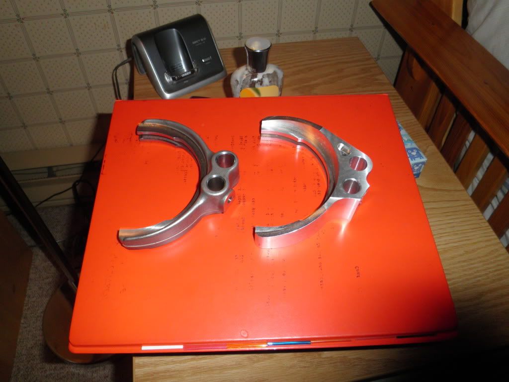

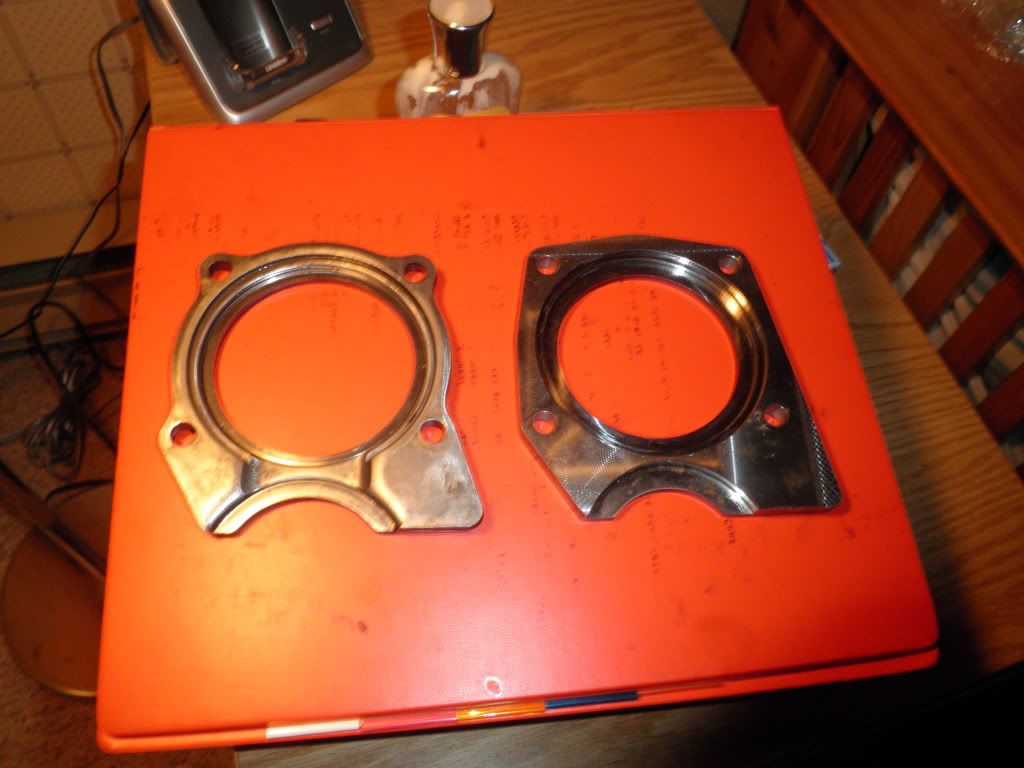

as well as Marlin intermediate plate
Marlin crawler 1-2 Shift fork
as well as the marlin crawler thrust washer (no pic)
