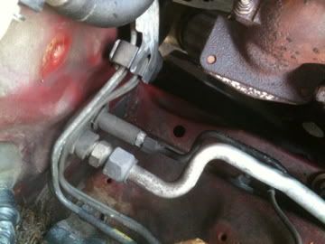

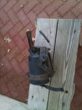

On to the next one. I'm trying to replace everything that the PO removed. One being the charcoal canister. The hose on the bottom of the canister goes into the frame, but where does it go after? I've looked under the car but could find where it comes out of.
Not the the canister is upside-down. I'm referring to the steel tubing.
The hole in the middle is where it should go, but then what?

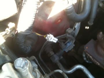

And the last question. Where does this connect to?
Its around the area where the charcoal canister bolts up to.

Charcoal cannister:
The bottom pipe doesn't go anywhere else; it vents down there.
That vsv looks to be for the heater core valve on the firewall.
It's supposed to be mounted right under the valve, currently located above it.
