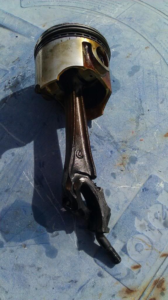

Don't use that additive stuff man. I had an mk2 back in high school, I got an oil change from the dealership then put in an oil additive (think it was zmax)...~2600 miles later...BOOM!!! Figured out after tear down that there was only ~1 quart of oil in the pan, took a hard turn at high RPM, oil went to one side of the pan and starved the 2nd cylinder...
