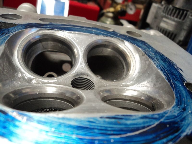

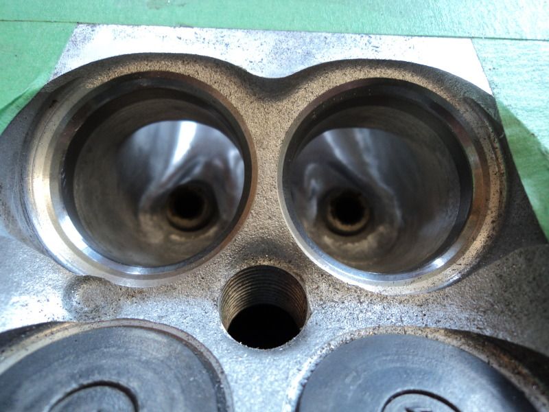

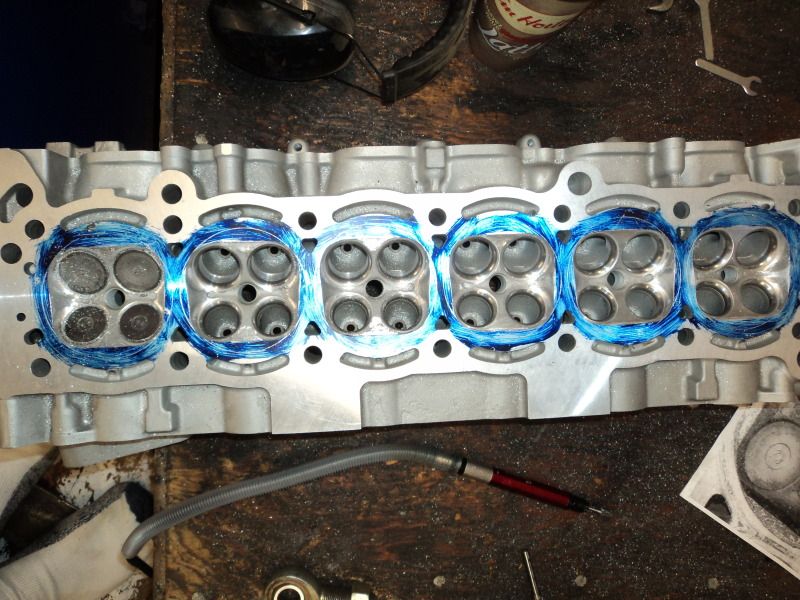

Well I have been doing allot of reading though out the years on this subject , and now doing head's for other people here is one I am doing right now

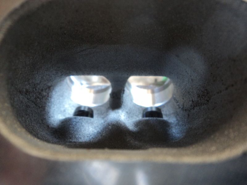

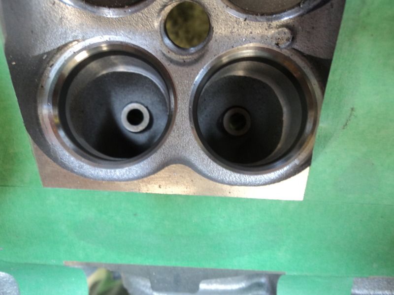

here is what a stock head looks like this is good on to some of them have some nasty casting bulbs in them
detail's thus far
de-shouded valve seat's then slight plunge cut
and this is were I am now
this is mild light porting/blending and clean up it's not fully done since there is some parts to work on mainly the part a round the valve seat need to be taken down and then gasket match it

well got so more done today

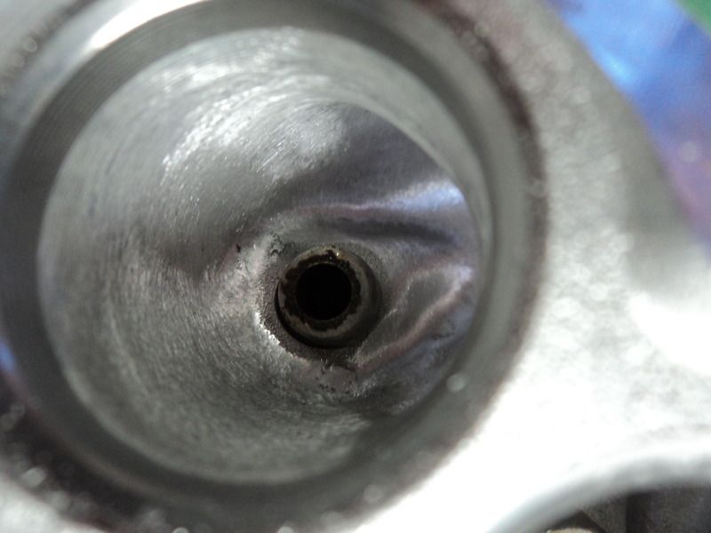

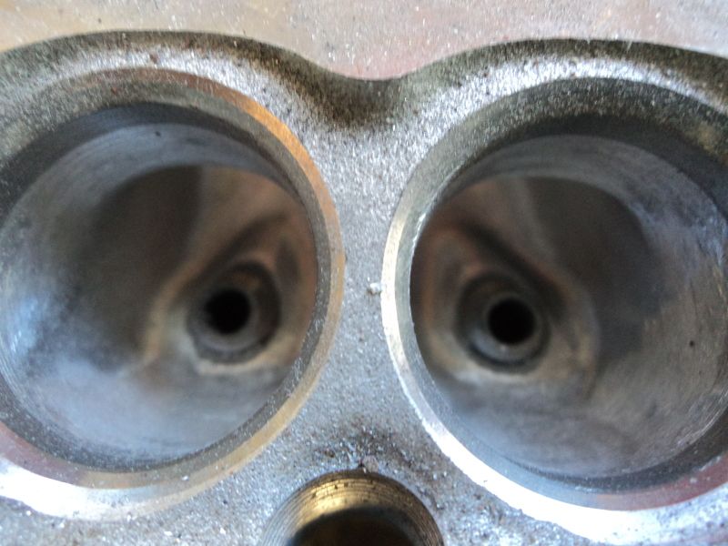

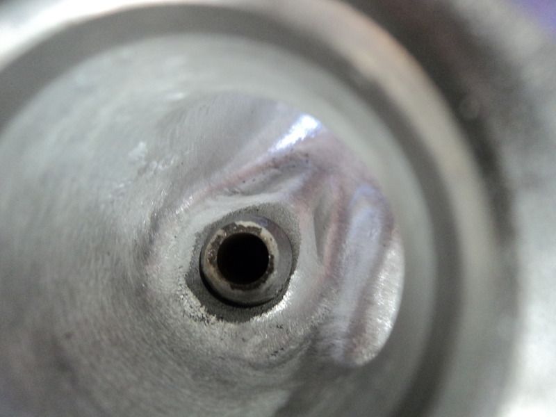

finished roughing in all the intake ports and did some conning of the valve guides
stock
conned

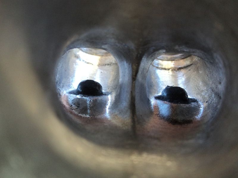

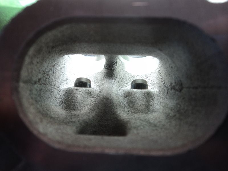

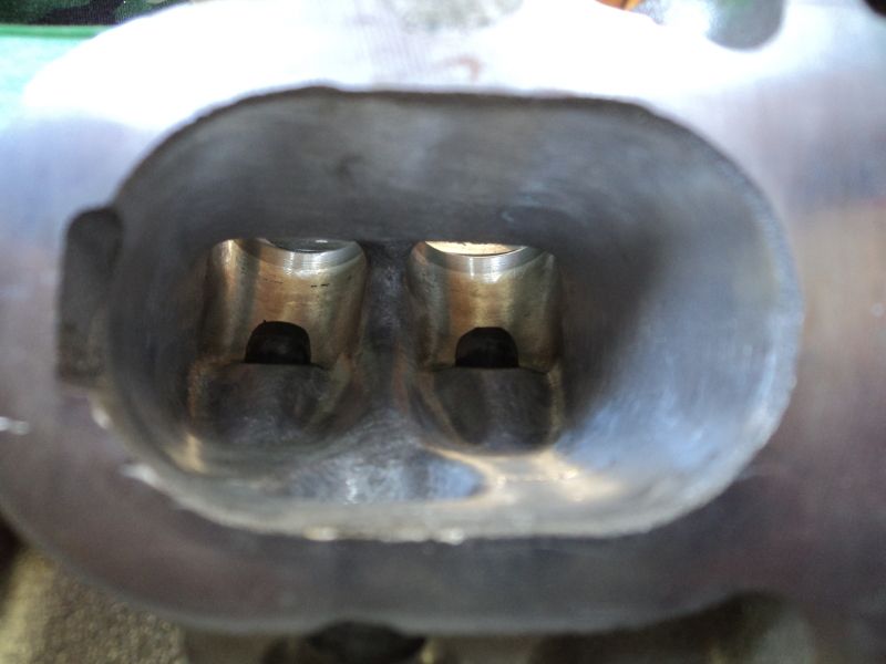

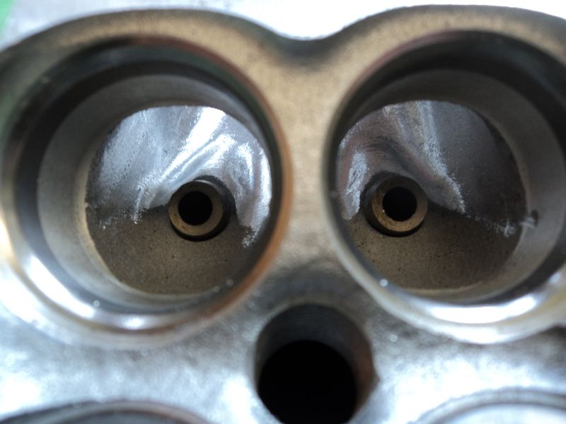

well i have fished the hole head and figure she will flow alot more then stock
I will be building flow bench coming up here for when I start on my wild head i have in my mind
any who here are the pic's
if any of you guys wana do this at home and no worrie about mess it up. Just take down the area around the vavle guide and open the up the grove abit and then cone the vavle guide, mix this with slight deshording of the valves and you be shocked on the out come for doing so very littel
oh ya the head not fully finished just need ot take the sharp corners off in the combustion chambers

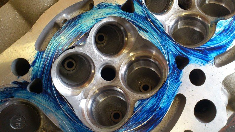

for the next wild head the hole valve guide casting seat is being hogged right out and then the valve guide being cut down to about the high of the stock floor is
and I still working on my combustion chambers but I have to cc them before I go further and allso take mold of the chamber and send it off to je pisonts
but i need ot talk to je about the combustion sides (much like 2jz head) but if I take to much away not sure if they can make piston with out it popping out of my block and messing qench and stuff
all so going to be running stock sized 2jz valves
