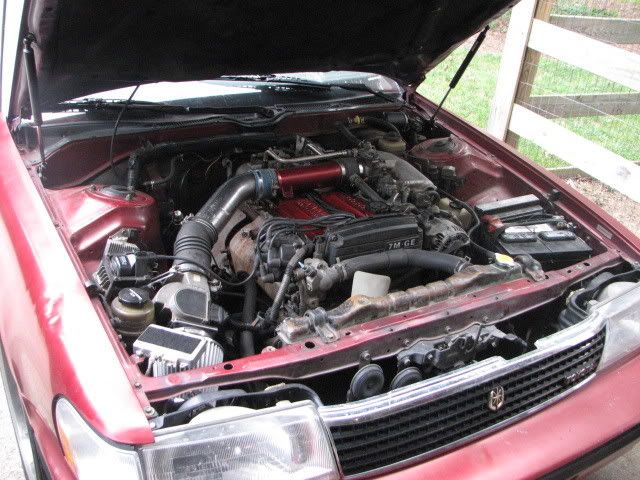

Wouldn't the ideal setup be to use a 7M-GE valve covers with the throttle setup from an MX83 Cressida (which was a 7M-GE that used the 7M-GTE intake manifold without ACIS)?

I can finally sit in peace in front of the pc to do some googling. Here are the first few, and decent, pictures I found. Posting them here for future reference and anyone else that may want/need these.
Jeff's right, it has a 7MGE with the GTE intake manifold. In the last picture, if you have a really good eye and know what you're looking for, you can see the throttle metal tube running behind the 3000 pipe.

The Cressida throttle link. Sourcing a JDM TB is pretty hard. If you're keeping the EGR then I'm sure you'll need the pcv tube as well.

hey man well i just picked up a cressida throttle link and pcv pipe.
here how its suppose to look like up close!
