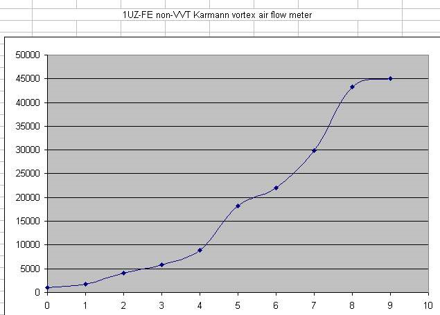

In times past people said they sprayed MAF cleaner in it, after a K&N was in place for 75,000 miles. We don't have a lot of options in that regard. I bought an actual 1UZFE meter on ebay years back. It had the same electronic part with number from Fuji. And I could be remembering wrong. It's worth checking.

Sensors 1UZ and 7M have different characteristics.
