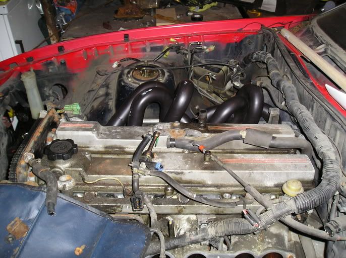

HKS Twin Turbo Manifold on the side of my parts engine...gives a good idea where the turbos end up...the manifold belongs to a friend.

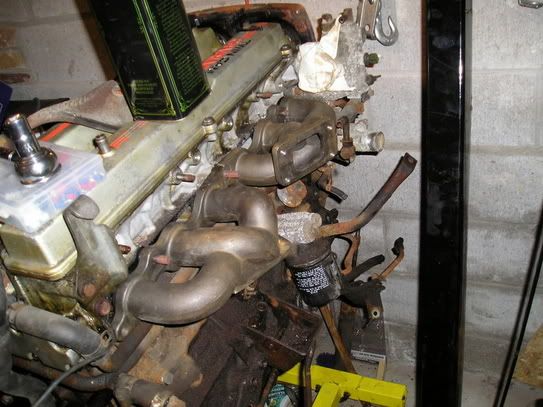

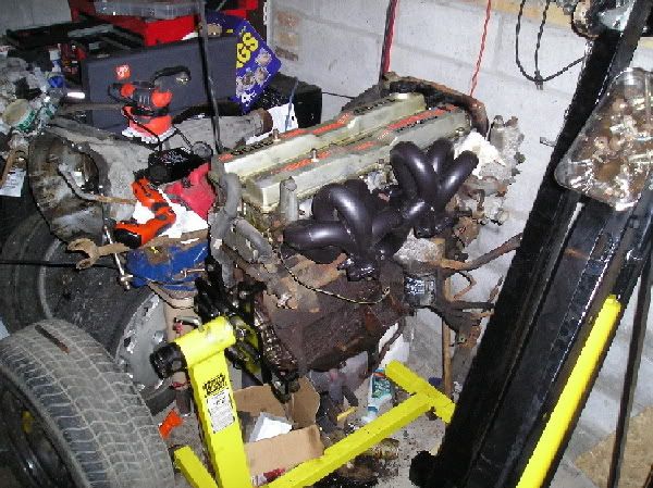

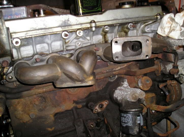

YSR Twin Turbo Manifold (Still not completely sure on it being a YSR, but the source was reputible, though there are no markings to be sure) Greddy style twin turbo manifold (differences from the Greddy include how tall the runners are and the routing of the #5 and #6 runners, as well as some difference in turbo placement)
on my old parts car...
