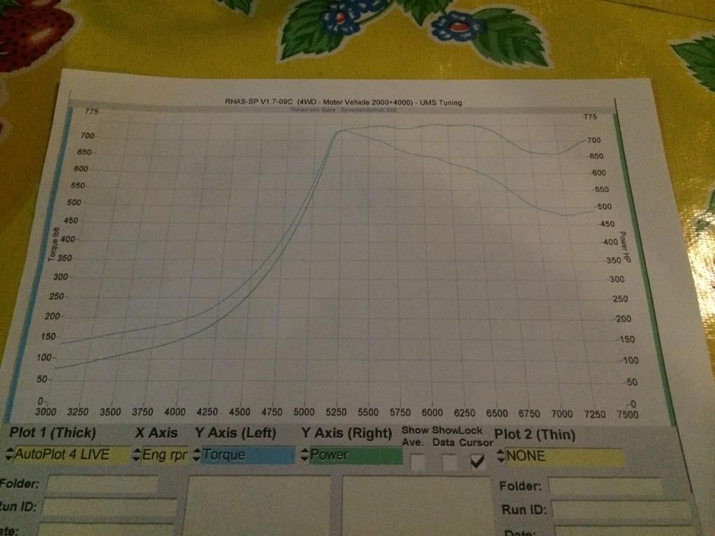

That's a sweet sound.
How high were you revving too? Seemed like the longest dyno pulls ever. Lol.

Only reving to 7500 on the dyno. I turned it back up to 8000.

IndigoMKII;1998177 said:
755 rwhp, 730 rwtq. That's nuts. You also got them to peak at the same time, how much timing you got in it?
It's cause I make peak torque at 39psi and it drops down to 34psi through the rpm where I make the 755. If it held at 39psi all the way I may have been able to crack 800whp

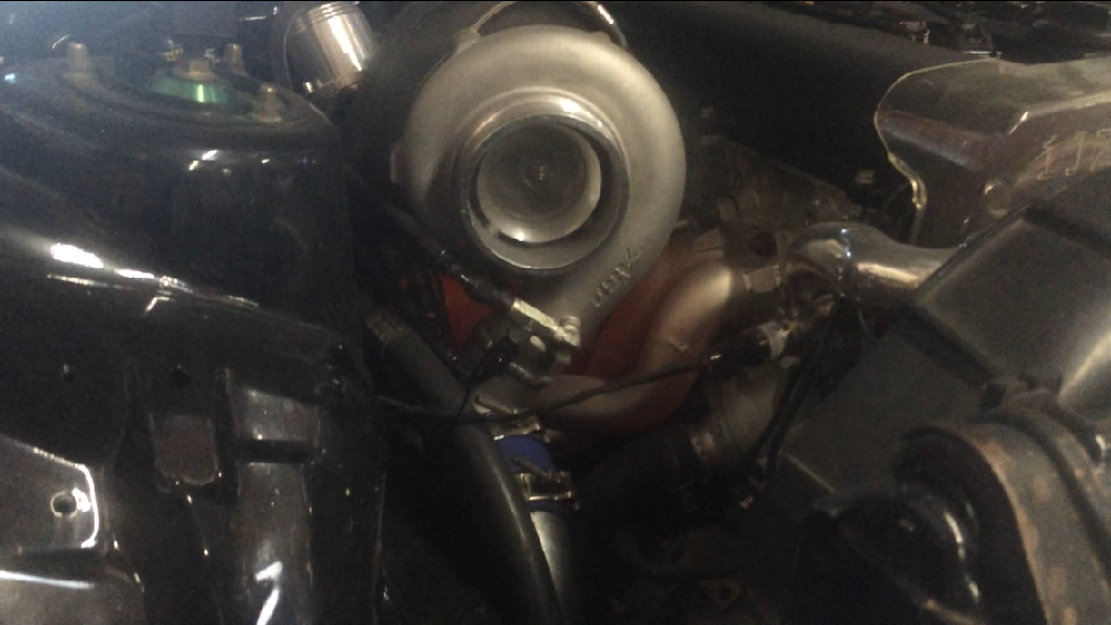

Albert;1998252 said:
No I'm on a 6265 (zeta 3.2) now
Jesus thats great power from a 6265 and some big boost. you running E85 im guessin? i just switched to it from pump 98 and its great

Nice numbers from a 1j. Like the others asked, what gear did you dyno in? The run seems to go on for a long time. Im makin 778/640 and my dyno pull on a DynoJet is 6 seconds long looking at my logs with a 4th gear, yours is almost twice as long, just figured your run would be quicker. 5th gear maybe?

4th gear.
