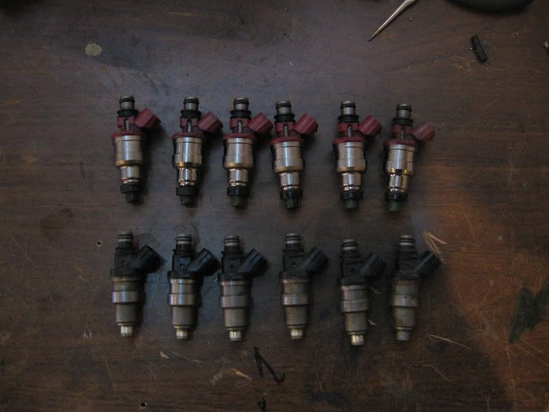

ryanday
Jan 27, 2007
28
Porters Lake
ND make 550 injectors that will fit in the 7m. you can use the injectors out of an 87 rx-7, i belive there are some of them with high and some with low imp. injectors tho. But thats what mine are --->
