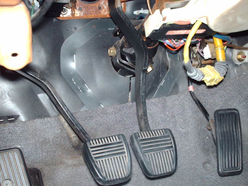

I used the clutch (I think, maybe not) pedal and brake (I for sure used the JDM brake pedal) from my clip. They work but not very well.
You can only press down the brake pedal about half way because it hits the steering column.
Also, they brake and clutch pedals are about an inch from each other.

Damn EPS...that looks scary!!! Do you have Steel Braided Brake Lines?!? If not, I can see that steering column being an issue. And if your feet are as big as mine, I can see the Brake and Clutch pedal spacing being a pretty big problem too.

also you could us the 2000 celica gts pedals i have a post on how to do this mod in the SF site search for Bad A$$ mod i think here is a picture so far with out cartpet layed in.
O and before someone bashes my mod i am the first one to put 2000 celica gts pedals in my MKIII supra lol because people like to bash how i advise i thought of a better way to deal with not having to extend the harness as far as i thought i was the only to go through the speedo hole I told a friend that did a handfull of 1jz mkiii swaps he said he never heard of it and goes on these forums and he thought i was nuts but it worked and other people do it now after seeing how it is so easy.
People have done this pedal mod to old school celicas corrolas and what not it is verry easy to do and cheap and factory looks breath taking and works great!
I used the whole celica gts gas pedal with a slight mod to it it works better then the supra pedal it haves a larger counter weight and stiffer spring on it a verry solid feel to it also if you installed the 1jz you will notice the wheel diameter on the throttle body is about 10-20 % smaller well the jdm pedal is slightly diffrent then the US one for this also.
so when you use the us pedal with the 1jz throttle body you sneeze or hit a bump and its easy to stomp your gas pedal more with the celica gts its a lot more solid and better for bumps track racing what ever a much more solid feeling.
