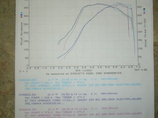

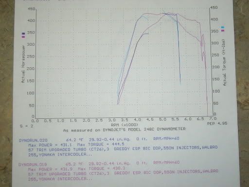

the first one is at 15psi on 94 pump. the second graph is on about 105 oct mix of race/pump gas at 18psi. It was still really rich but when we tried for more power my clutch said no. as you can see as it hit 444rwtq on pull #20 when it went up in smoke.
I went to the track later on in the night and ran at 15psi. The track was just repaved and the track was very 'green' I would spin through 1st and a most of 2nd then go snakey through 3rd and 4th. When I turned the boost up more I got traction because my clutch was slipping like crazy. Best run at 15 psi, first graph, was:
60' 2.373
330 6.146
1/8 8.942
mph 88.41
1000 11.274
1/4 13.227
mph 113.99
Car weighed in at 3450 with me in it after I removed the passenger seat.
86.5 7mgte/r154
57 trim ct-26, BIC ddp, test pipe, greddy sp, k&n fipk, profec b1, yonaka intercooler with custom BIC hard pipes, lex/550, walbro, safcII, centerforce df clutch (2.5 years old), stock motor other then greddy 1.5mm hg with stock head bolts torqued down to 60ft.lbs . 4.3 lsd, type s bov, thats about all i can think of now.
I drove 400 km to the dyno and track, did 20 dyno pulls, 5 drag passes and drove home. It only took 1/2 a tank of gas for me to go 400km on the highway home btw.

that's really good power for a very RELIABLE CT upgrade! nice numbers, and congrats!

I had a 57 trim too at one time, I never dyno'd it but seat-of-the-pants at 18 psi told me it was high, congrats good numbers

Very nice!! Should be low 12s with a 1.8 sixty foot!! :D
What are you using to controll boost? I cant get my upgraded CT to hold more than 15 psi...
One more thing.......what kind of dyno was this on?

wait a minute... ive got a bigger turbo and im running 17-18lbs.. i must be making more then this..

I was only running 15psi on that track run on street tires.the track was really slick, I spun right through 1st, and snakey all the way until I bounced off the rev limiter in 4th. without a boost controller boost will creep to at least 15 psi in higher gears. it says dynojets 248c, same one upgradedsupra used way back when...

Good job..It's a testament to what a good tuner can do for your car on a dyno with the right combo of upgrades of course. This is a friend of mine and is responsible for keeping my car in tune aswell..

Man, those are some awesome #'s! Time to register your car with 7MPOWER.com...I think you have the highest HP 57Trim I've ever heard of(?)!:aigo: It's just like JBL said, "It's all about the tuning",:boink: as he has gone mid-high 400's on a 60-1, with stock injectors! I have a 57 trim also, w/ the Lex, and stock injectors. My car feels strong, but I've kept the boost down to be safe.:icon_bigg I would guess I'll go about 330-350whp, untuned ,on racegas.
Congrats! Keep up the good work!
