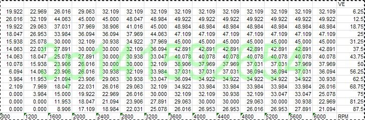

Attached is an image of the timing map. Haven't figured out how to attach files to this post. I would not use this map without a very capable knock-sense algorithm monitoring things. The stock ECU knock sensor is fast and pulls timing a lot during normal operation.

The USDM timing map already has timing being pulled under normal driving conditions. The JDM map shows many areas with additional timing. In theory, youd risk MORE detonation/knock retard with the JDM map unless higher octane could be used.
Since the resistor in R606 wont work for the GTE tccs, this is all null and void.

Yes, the JDM map does run advanced in some areas compared to the USDM. I thought maybe regular Japanese gas was higher octane than ours, and Toyota felt comfortable running it more advanced, but I don't really know.
If I am remembering correctly, my comments about the knock sensors retarding timing were referring to during warmup. With cold coolant the ECU advances timing globally, and the knock sensors will hear knock under light throttle and retard it. Once warm, I don't see a lot of knock retard generally speaking, at least on premium fuel.
Yeah, the resistors don't do anything on a gte. There are two ADC channels that can be used to select different maps for minor things, but nothing spectacular, just little tweaks. I need to get my run of boards built so people can start running home brew code on our factory ECUs.
