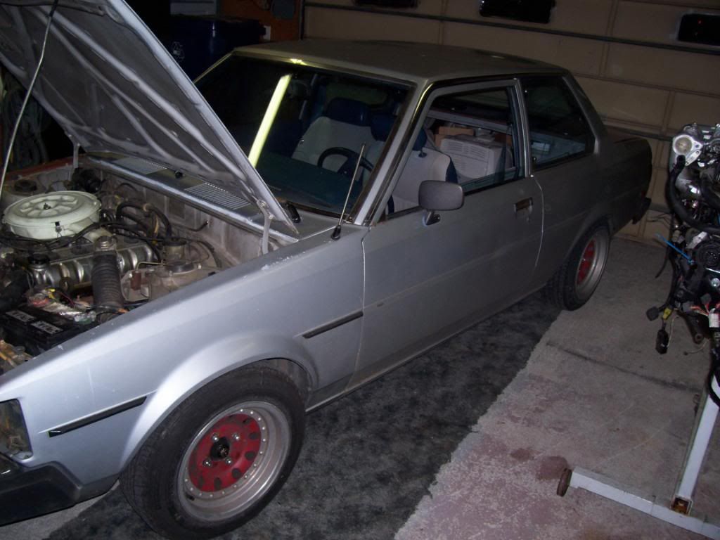

I am currently build this
eagle rods, pistons, gear drive, itbs, pushrods ,valves, buckets, headwork,all waiting for block to come back from the machine shop.
