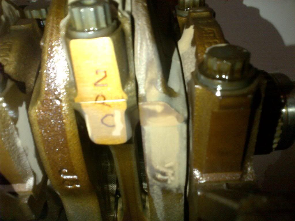

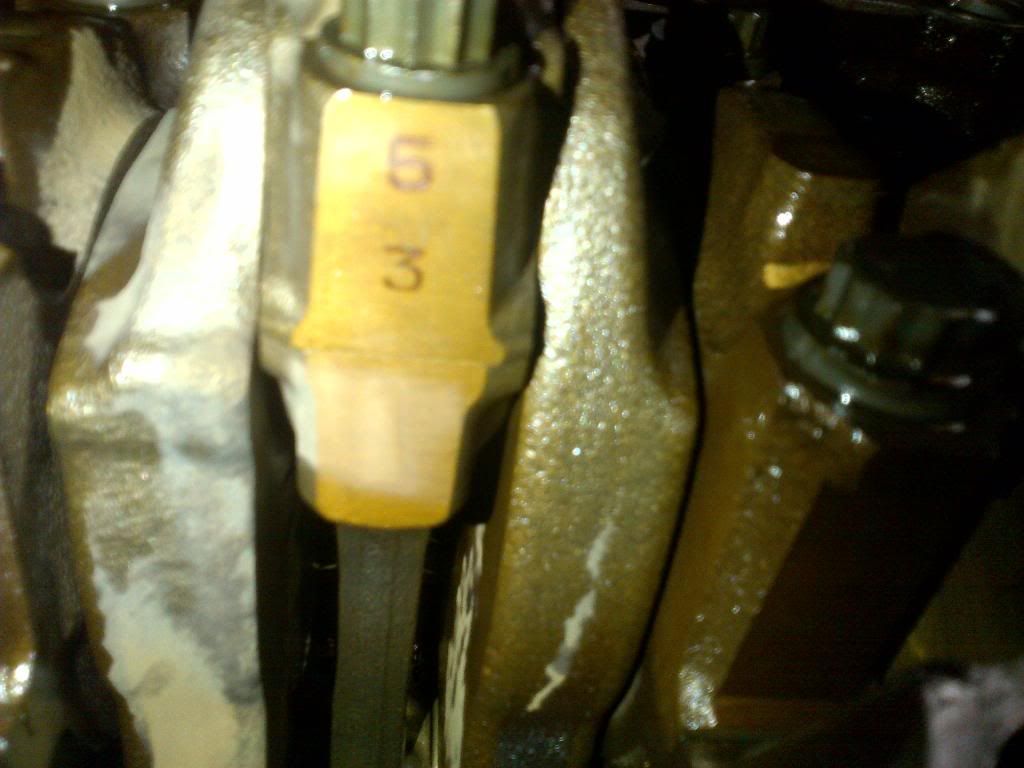

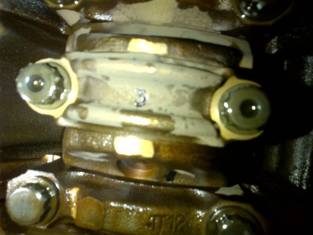

tore my engine apart to find where the shimmer was coming from and none of the rods looked scratched but i still have to take off the mains today. i have a question on the mark number on the connecting rods for the correct bearings to go in place here are the pics of the #1 cylinder connecting rod. Which number is it to specify the corect bearing? i have already found the markings on the block for the engine and crank and are as followed
Block:3333545
front crank counterweight:111111
rear crank counterweight:3223422
Side 1 "2,P,C"
Side 2 "5,3"
bottom of conn. rod cap "3"
