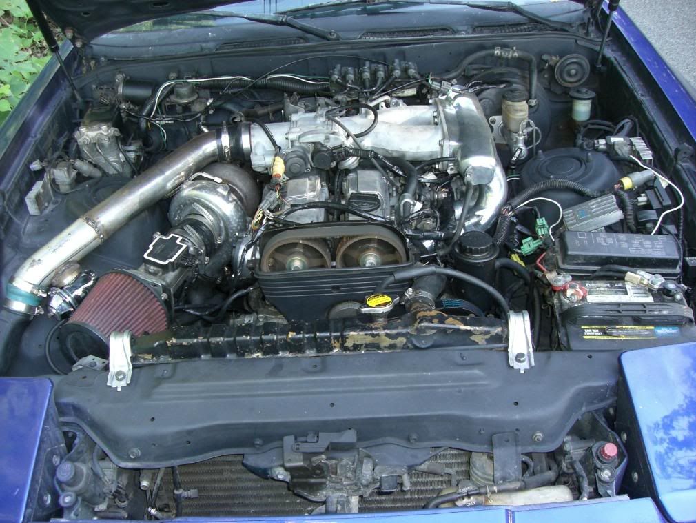

Few pics of my custom down pipe :icon_surp
its not the prettiest thing.... but it fits like a dream.:icon_bigg
I moved the O2 sensor back and up on top a little more.
the shorter pipe is what used to be the mid section of the down pipe. I had to get that press bent sh*t out of there.Its going in the scrap box.
BTW, you guys running the turbo sx header with a 50mm waste gate... What did you do as far as your dump tube.
Theres hardly any room between the waste gate and the frame... i think i can do it but id like to see some pictures of what you guys did.
my e-mail is silvergsx623@hotmail.com if you guys have any pics of your dump tube. Thanks

Just didnt' run one :) My WG blows against the framerail. I'm waiting anxiously for a knockoff of the Greddy WG to come out, it's rotated 90deg from the HKS and will put the dump facing the same direction as the DP.

Aah ok, Thats how mine is running now. When i was mounting the waste gate i wondered why it wasn't square instead of a rectangle.
At first I ran without one, then i got bored oneday and decided to make one. It didn't flow for shit but it got the job done. I made it by taking a straight piece of pipe, cutting it at a 45*, then welding them together to make a HARD 90*, then I just welded bends together to get it to the underside of the car.
IMHO the primary goal of a dump tube should be to get the exhaust out of the engine bay, and my dump tube did fine with that.
Currently, I just finished rotating the flange 90*, then it should be really easy to make a fully functional dump tube.

AAh cool.
Can u post up a pic of it, so i can copy it for mine? lol i was thinking about just putting a very short turndown on it, just to give the exhaust a downward direction.

Here are a few pics of the intake and upper inter cooler pipe i powder coated..
Also a few pics of the supra, I took it out for a spin and decided to snap a few pics.
Before:
After
random pics in a parking lot:naughty::naughty:
One of my favorite pics:love:
