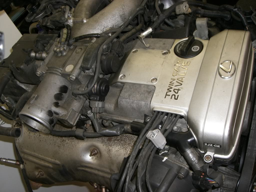

Motor Pictures

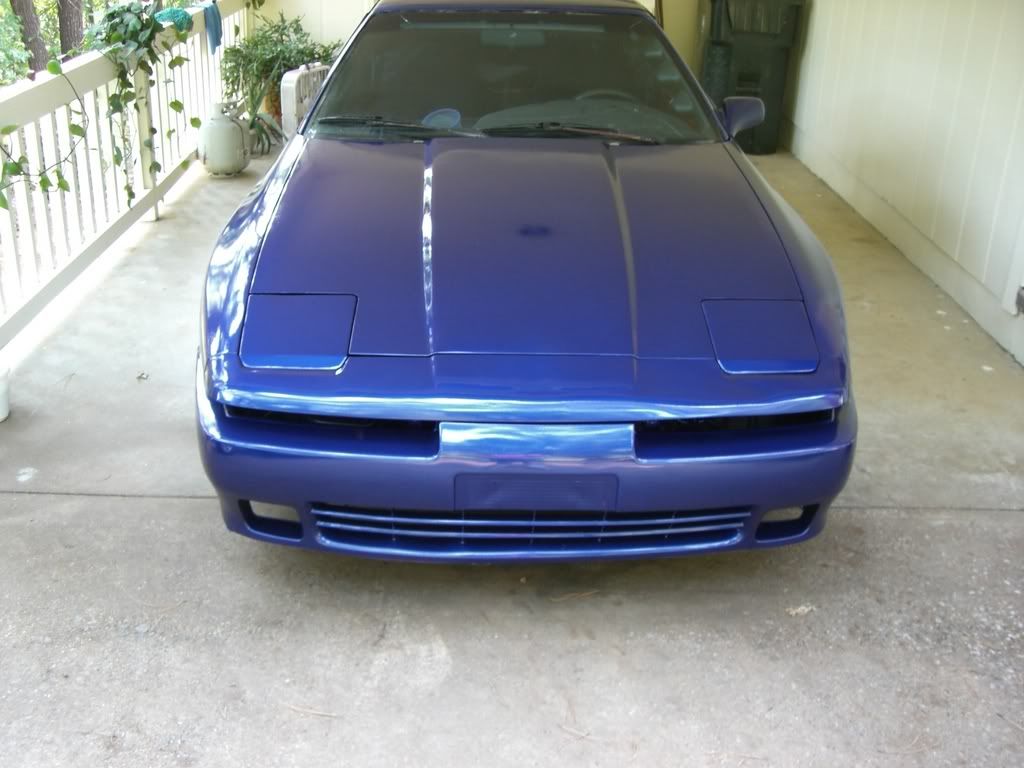

Here she is:
I plan take a lot of pictures along the way. Maybe someone else will find them helpfull.

What type of oil pan does this engine have? mid sump? Looks like your build is going to be fun.

silvergsx623;1024386 said:
I decided to polish the valve covers
You may just want to paint them, after two or so heat cycles the valve covers become hazed. The valve covers are made out of magnesium alloy which oxidizes much more rapidly than aluminum.

A-model_-I do believe its mid sump.
hottscennessey-Thanks for that bit of Info... I'll probably powder coat them then.
How about the intake manifold/throttle body assembly? Is it the same type of alloy. They look different then the valve covers.
