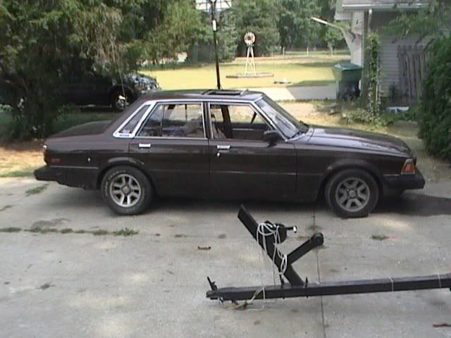

Ok,I had seen your Cressy in your intro post,didn't realize that was you,looks like a pretty clean car.Seems that body style is far more common than mine (MX63) are.
It's about 3 hrs. to Lafayette from here.I travel constantly during the summer,
maybe I'll swing through there sometime when the snow's gone,I don't like to drive my 2-tone Cressida in the snow,and don't trust the other one that much(crazy the one with over half a million miles is the better running car.)Good luck on the swap,keep us posted.
Here's mine:
