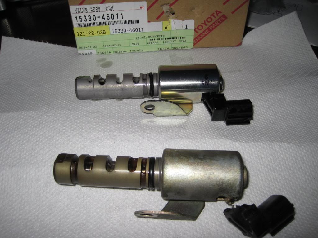

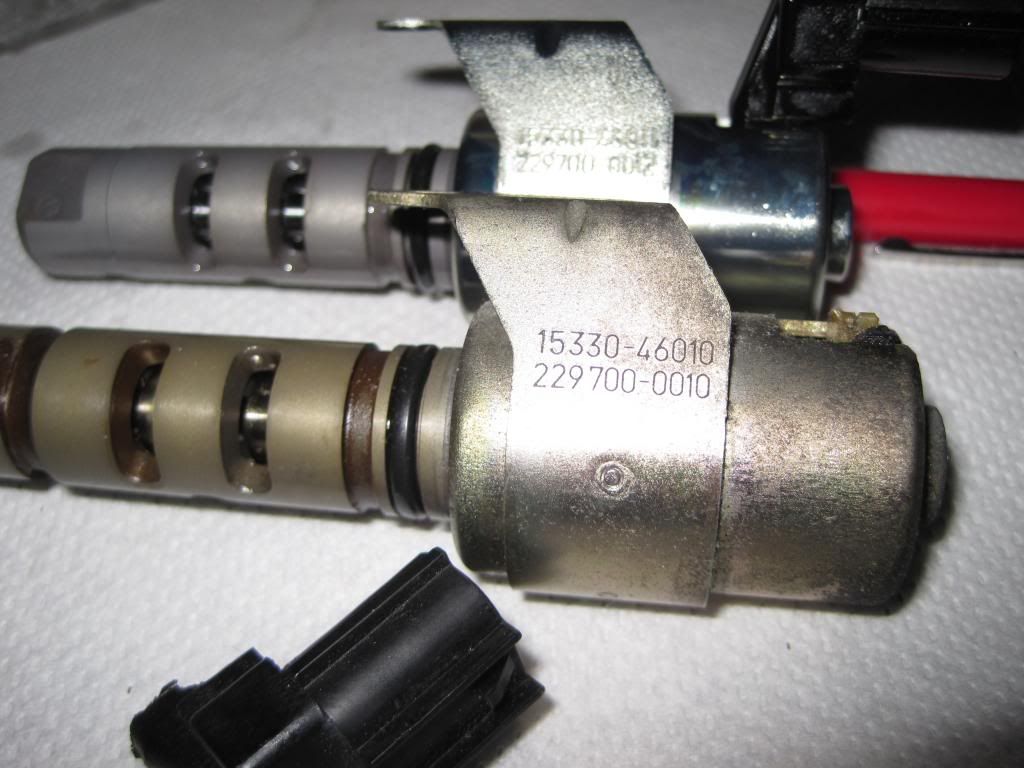

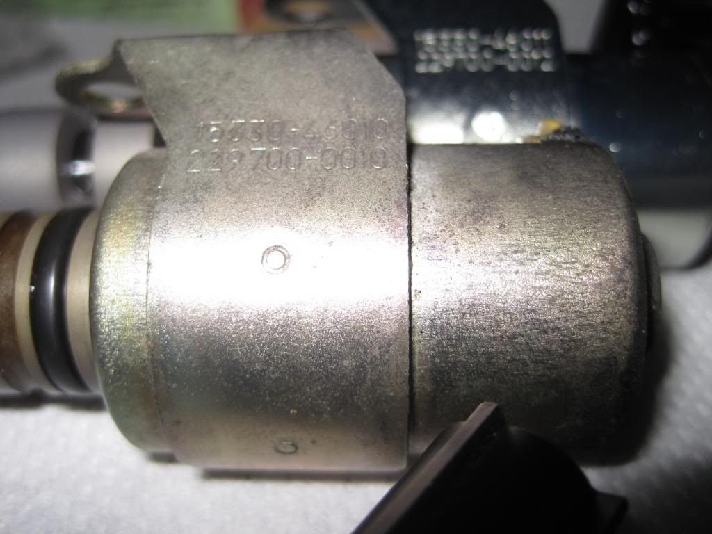

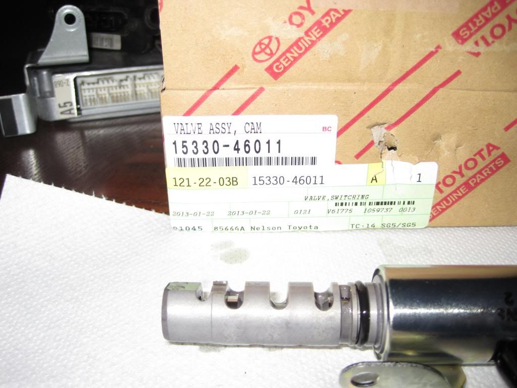

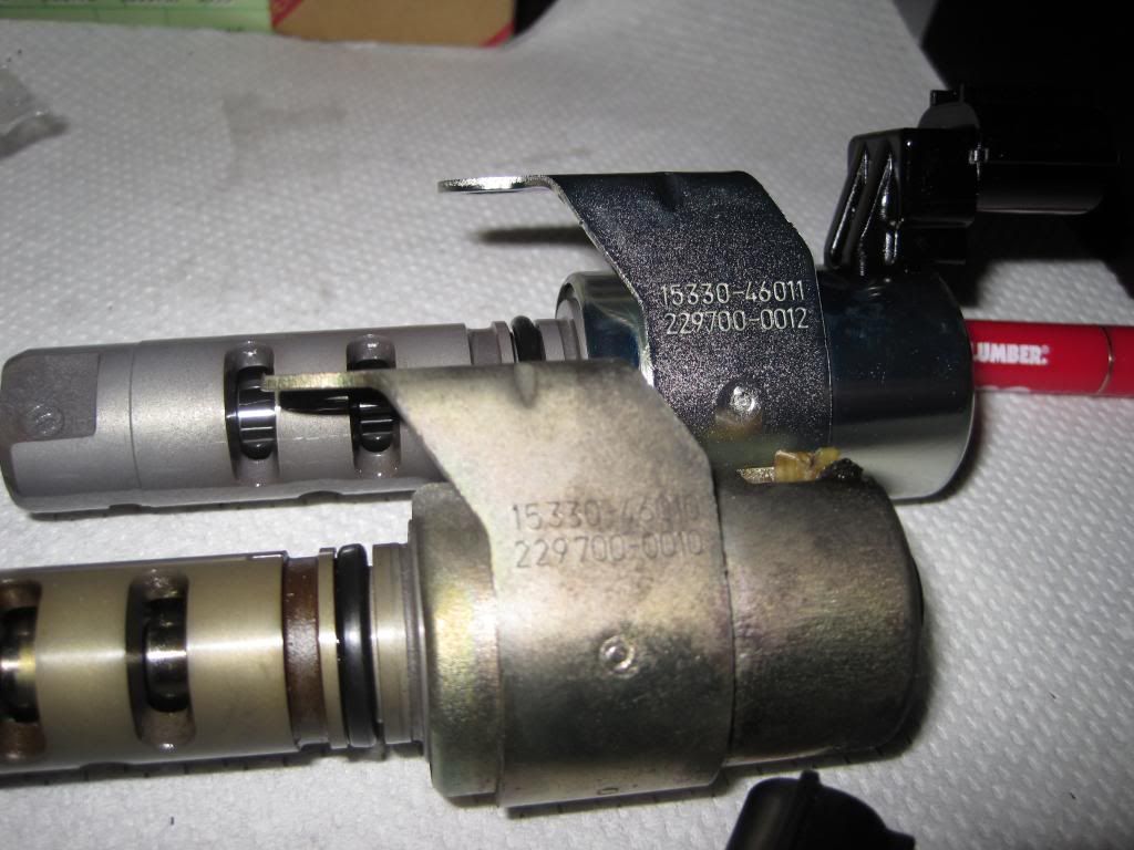

This is a very hard question I think. But I need help with this. I got my engine from the importer and the oil control valve for the variable valve timing had the connector broken off somehow. This engine I have is a 2JZ GTE Aristo engine with vvti. I went to the Toyota dealer to get a new oil control valve and what I ended up getting is the oil control valve that they could find in their computer. It is from a 98 Toyota Supra non turbo with vvti. I have both of the oil control valves with me now and I am noticing some differences. I took a bunch of pics. I am wondering, will I be able to use this new one? The part number seems to be slightly different. The GTE one from my Aristo engine says 15330-46010 on it. My new GE one says 15330-46011. Also, if you look at my pictures, I notice that the GTE oil control valve(on the right side in the pic) has a snap ring and it appears to have a larger hole in the end. Where as the GE on on the left in the picture has a smaller hole in the end and doesn't have a snap ring. I have questions about this. Will it work? Will my engine run different with the GE OCV then it would with the GTE OCV?

The 46011 is the updated part number. Had the same problem with the 1jzgte vvti that I got, original ocv had the same part number as your original one, but even for the vvti 1jz, it is the new part number that is listed.
My 1jz has been running and driving in -45c with no problem. No MIL light yet but maybe I hooked up that wire wrong hah, no performance issues anyways but its hard to tell because in this weather my tires spin at anything more than 1/10th throttle.

15330-46010 is the original OCV for all JZ (1JZ, 2JZ, GE, GTE) engines, the updated part 46011 was released within the last 2 years as an updated part.
You've got the right one.
