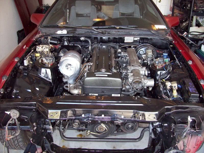

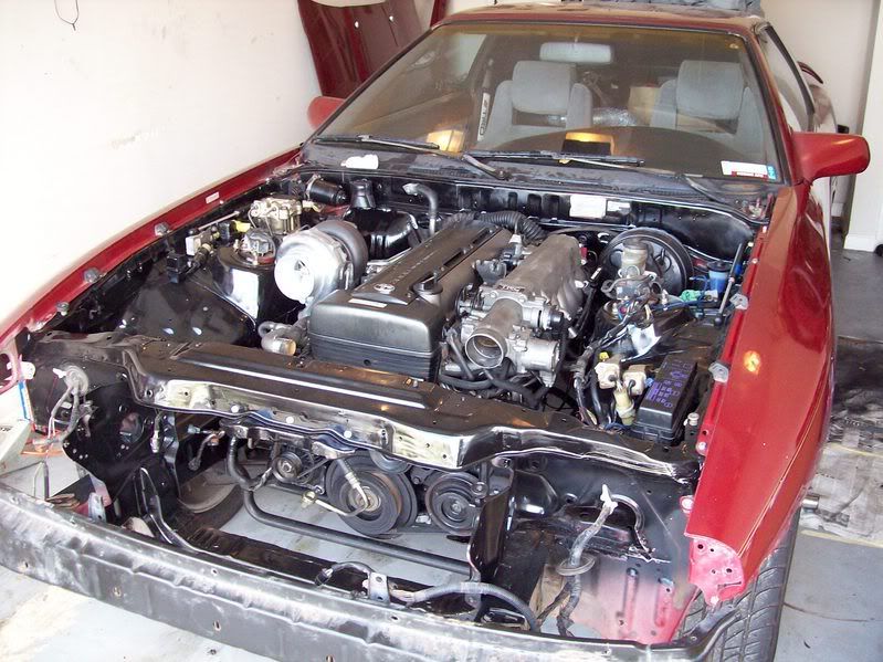

alright. i ran into a problem with putting the engine in the car. the sway bar on the botom... is that really important? cause when the suspension moves it hits the crank pulley...i could just take it off and be ok... and for some reason the front end is still like 1 foot in the air. like when you take the engine out... it still looks like that
this is what i'm talking about
