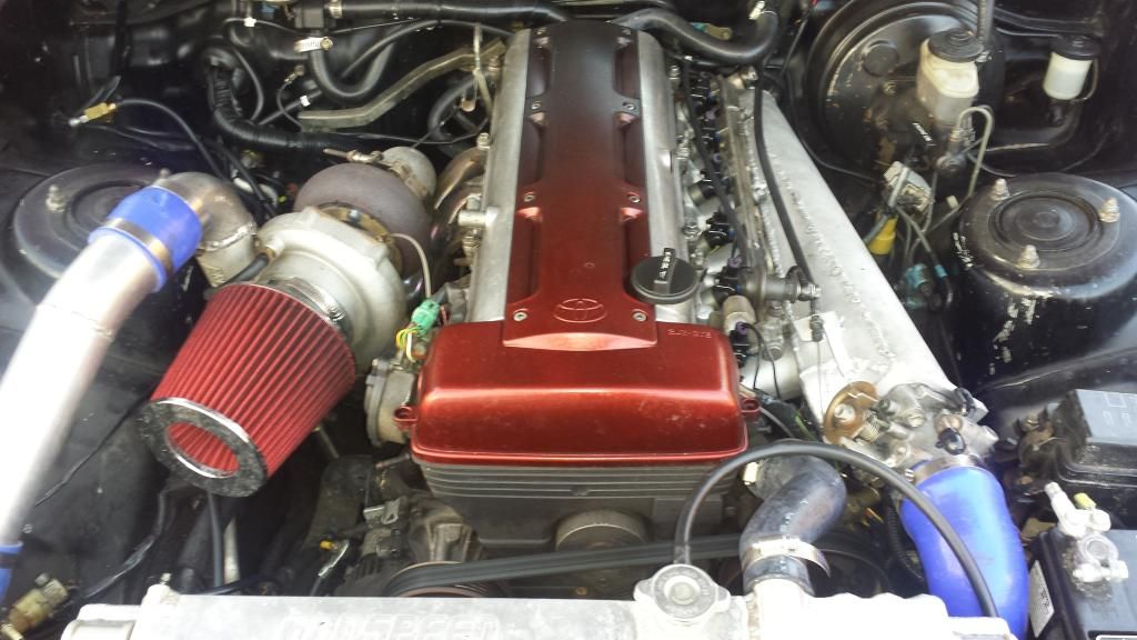

So the issue I have now is the car is having this cut out issue when you take off from a stop it doesn't even get to 2k rpms and it just cuts out and the engine light flashes. But if I take off really easy it doesn't it do it.
Then if I am in 2nd gear and push the gas down it gets to like 3k then it cuts out and will backfire usually.
I am running 880cc injectors 255 fuel pump stock 2jzge fuel rail and regulator,safc2/vpc setup, on 7m electronics 7m cps 7m coilpacks.
If I'm in neutral and rev the engine it will go past 3k no problem just does this weird cut and CEL flash the CEL is on do to o2 sensor not being connected actually doesn't even have on on the downpipe. (Just bought this car so it's a work in progress) guy says he took it off to get a better tune on the safc I guess... I am going standalone soon as I get my taxes back but I want to drive this car I drove it back from oklahoma just fine and drove it one other time then this. So I'm wondering what you guys think it might be? I checked sensors to make sure everything is plugged in the IAT was unplugged so I thought that was it but didn't fix the problem.

Found out its the tps plug I completely lost throttle response last night a few times push the gas down and got nothing then it finally would just go back to normal so I fiddled with the tps plug and actually got it to make a pull in first gear which was exciting cause its been awhile. Then it went back to running bad. My tps plug is completely broken.
