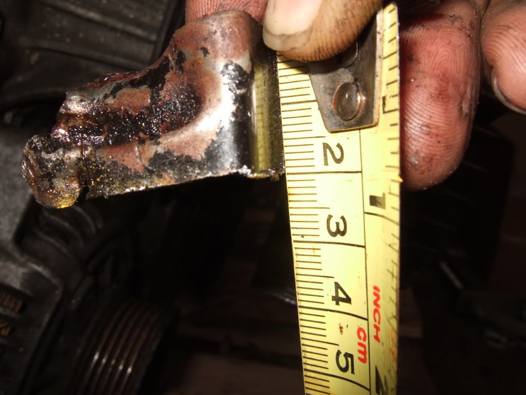

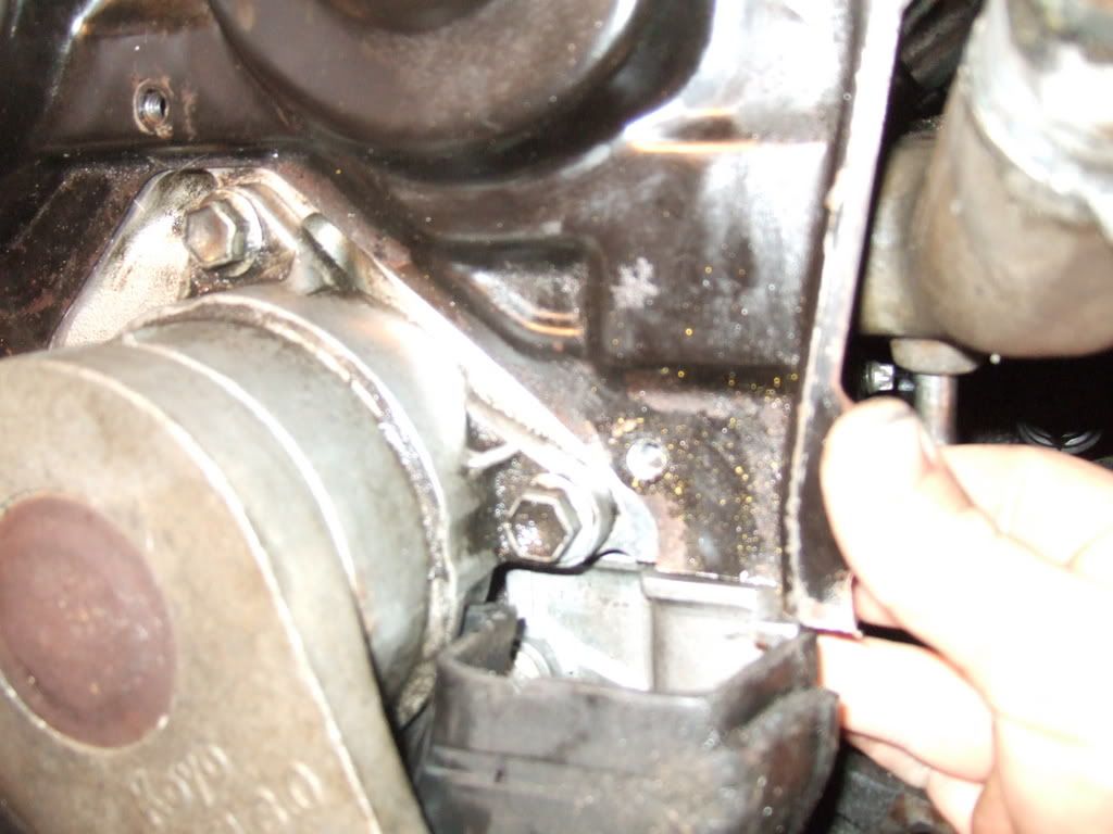

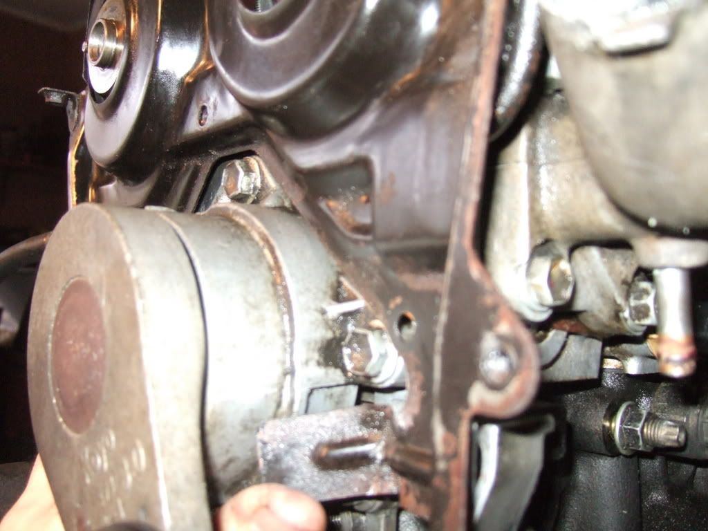

Here you can see where you need to cut. You need to cut BOTH SIDES if you want success!!!!!!
Measure.
Nice!!!

Yeah, the pic was before I changed the tensioners. Swapped them, now it's perfect.

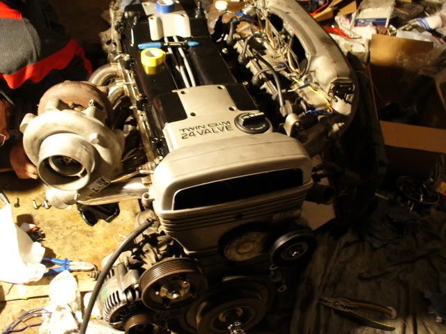

The cams arrived, and so did my buddy club wheels, but that's another thread.

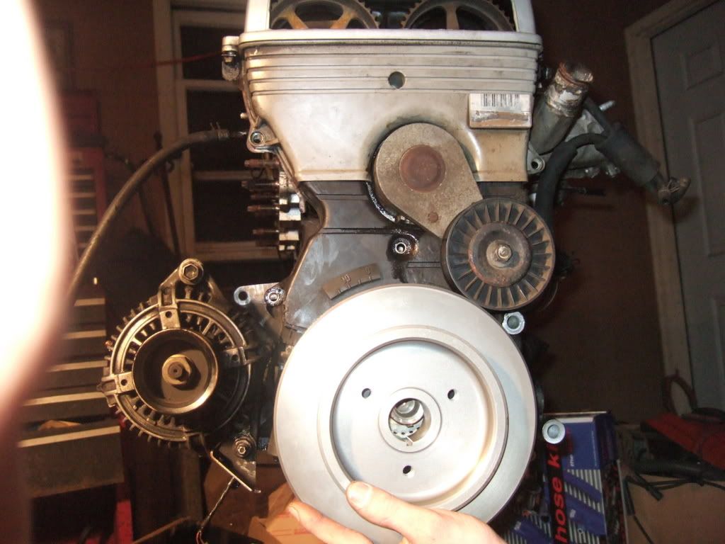

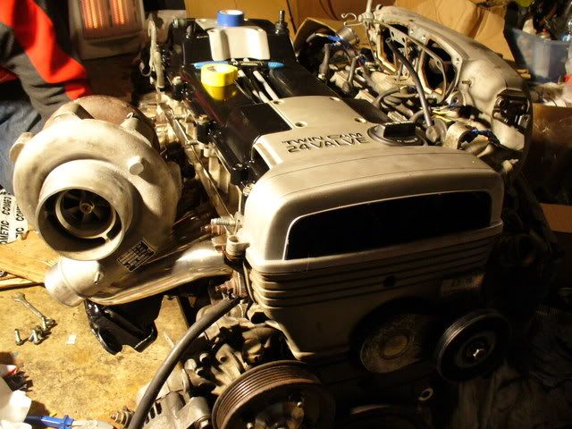

So this pretty much is it. We'll see how it runs. I need to install a radiator, probably one for some V8 with the inlet to match the 2J-GE water return.
Now that everything will fit, we can clean the motor up really nice too, lol!

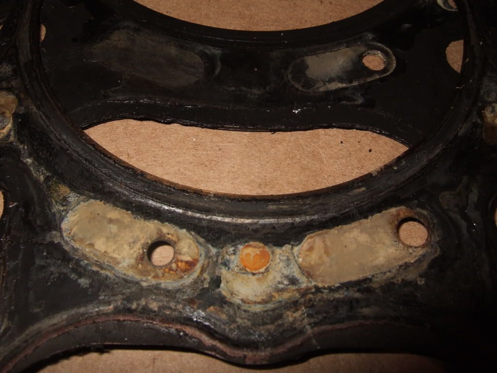

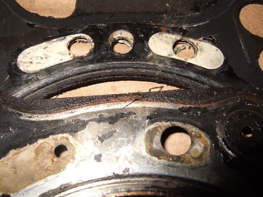

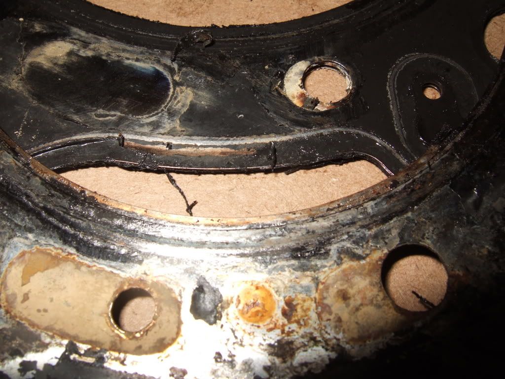

After that post about the head's being different for cooling, I took some pictures of the headgaskets, and you can see where the coolant holes start/end, and what gasket has mission holes, larger ones, etc.....
Oh yeah, 1JZ is underneath the 2JZ-GE gasket
The 1JZ headgasket actually has less cooling holes made for it than the 2J-GE head does. However, some of the holes on the 1JZ gasket are slightly larger than the 2J-GE stock, but the point is, they line up and should work.
It's mostly going from rear to front anyway, and will flow through the head.

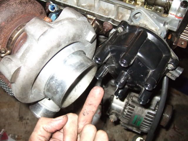

to bad that wasn't a gte head,so you can use the 1j coil on plug and cam sensor's.
nice to see someone try this,most i've heard about this is hear-say.i've never heard anybody in the state try this.
does the 2j-ge head port's look bigger than the 1j?maybe a big set of cam's will help it breath and turn some big rpm's

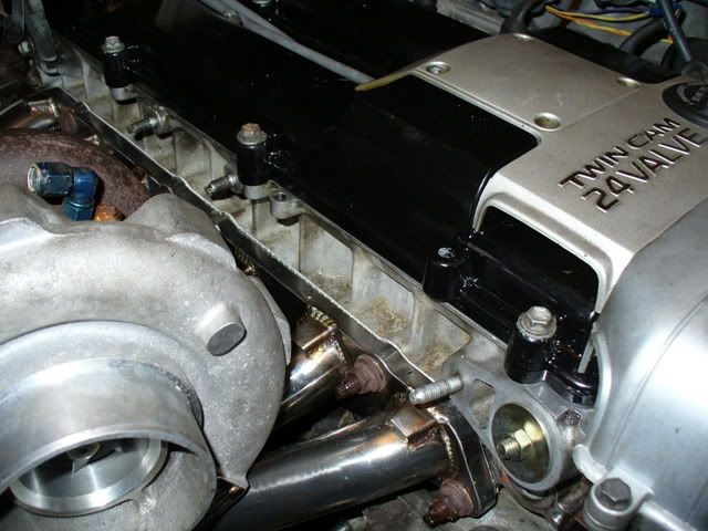

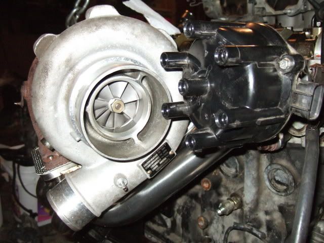

550's installed. Turbo manifold installed. ACT clutch installed with feramic disc from HPF (I hate those c-clips!), R154 installed (not shown).

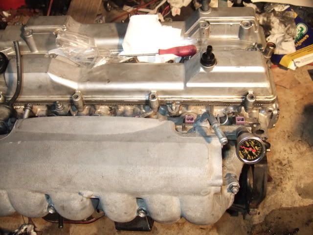

bigaaron said:
One sidenote, you can use a stock 7m CPS as your 24 tooth trigger wheel!
:ugh2:
Yeah yeah, still not on the car................... I love trial and error!
Regarding this engine, it's the first of it's kind, ever.
Maybe I should post what needs to be modified on the 7M CPS.... Because it requires significant cutting too.

Old pics lol. Using custom 7M CPS with Hall sensor attached for EK6.
Almost. We still need to midify the water return from the exhaust side of the head back into the waterpump. We used 8mm EDIS-8 Ford ignition wires, because they are long enough! I'd rather use some other type of coils, but 7M coils seem to be best for this.
