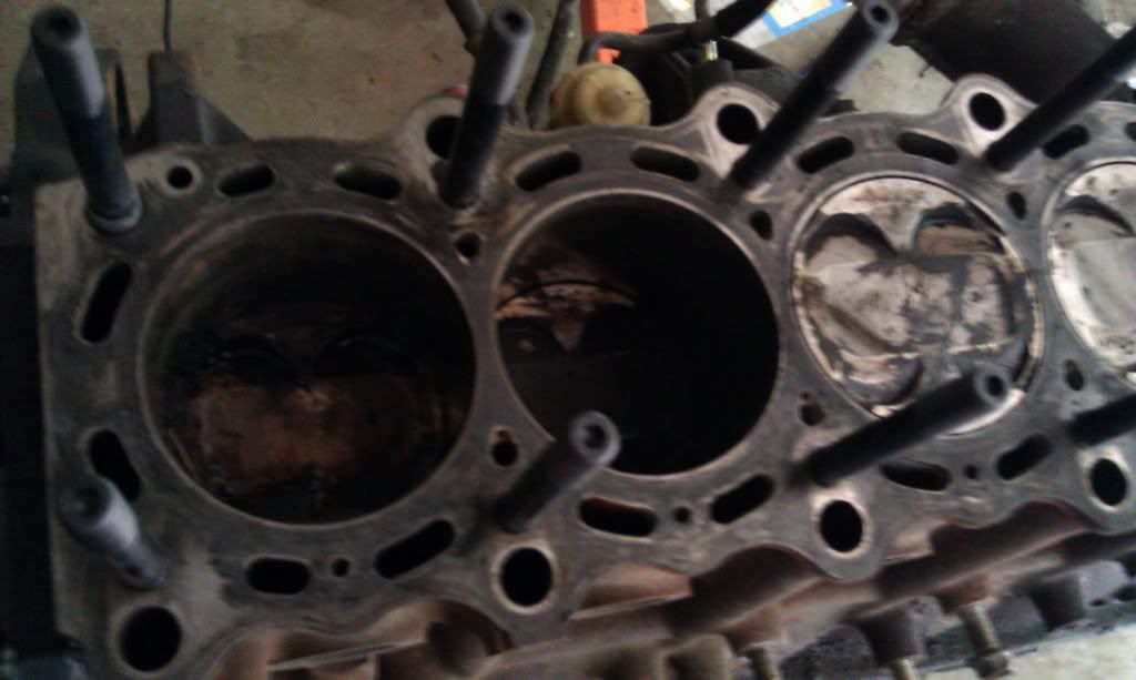

2jz Block Surface
pagii
Oct 11, 2010
82
Madison, WI

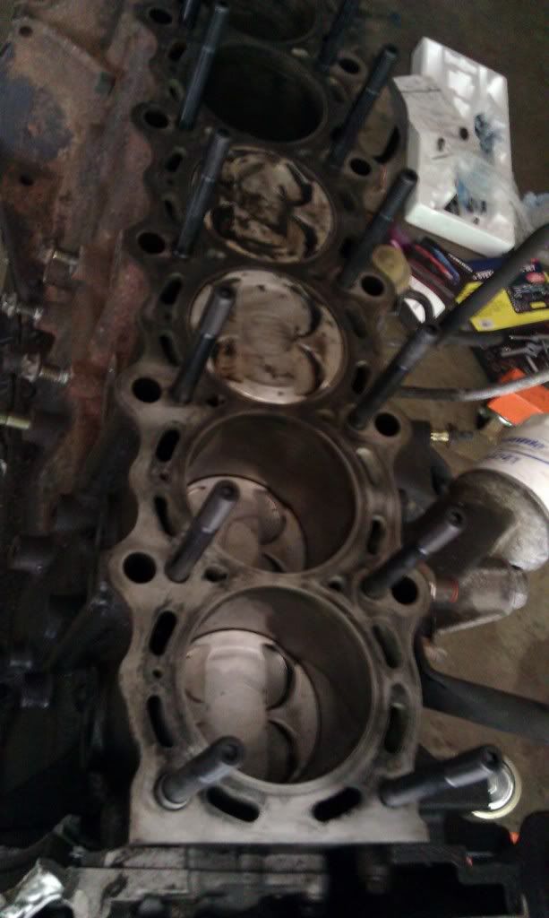

Can anybody tell me how clean the surface needs to be? I having a hard time cleaning it. Im putting a stock 2jzgte headgasket on...i have cylinder 1/2 pretty shiny and its pretty smooth im not sure if its enough tho...

Needs to be as clean as possible since jz use mhg. Best bet to remove the studs and use a razor blade.
Be better to machine it but doesn't look like your going that far into it.

Like he said, a razor blade. Buy a razor scraper at the auto parts store for a few bucks. The surface doesn't need to look perfect like a mirror, it just needs to be flat and free from crap. You won't remove discolored spots in the metal without having the block resurfaced at a machine shop, which is the best way to do it, but isn't required.
Don't use any kind of file or abrasive paper or similar. They will ruin the flatness of the surface and will cause a blown headgasket.
