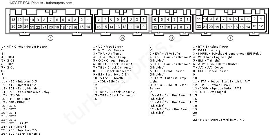

There are a few discrepancies though. I'm working on modifying an Excel doc that an AEM board member used for the 7M. But i need to change it for the 2JZ. For right now, you can go off of

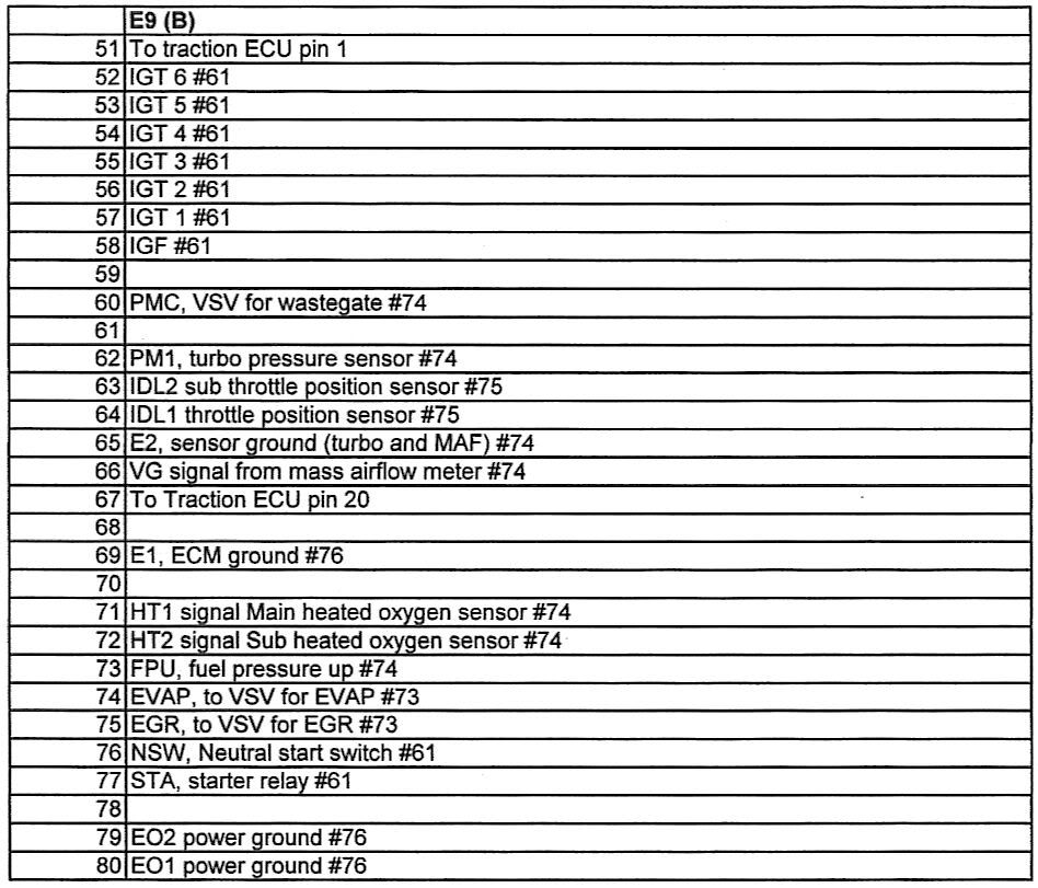

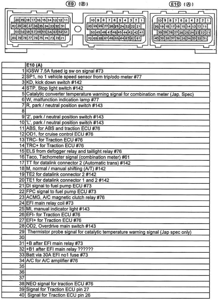

1JZ-GTE ECU Pinout:
2JZ-GTE ECU Pinout:
1JZ-GTE ECU Pinout:
2JZ-GTE ECU Pinout:
