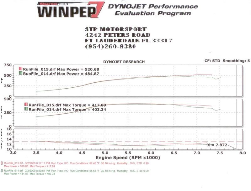

I finally was able to get to the dyno and tune the new parts (PT6262A turbo & HKS 264 cams). I went to STP Motorsports (real nice guys!) and Andre tuned her for me. Here is the list of mods
- 1JZ stock
- HKS 264 cams
- Sard 650cc Injectors
- PT6262A turbo
- 3" full exhaust
- PT 31x8x3 fmic
- Blitz ECU
- Emanage Blue (only fuel tuning, no timing)
- 93 octane pump gas
- 17-18psi boost
520whp and 418wtq!!!!!
The car feels GREAT!!!! sooo smooth running and rev up HARD!!!!!
