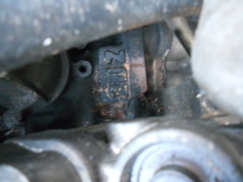

Also if you look at the engine it has 2JZ stamped on the block. And it uses 1jz vvti head and all electronics, including the ECU.

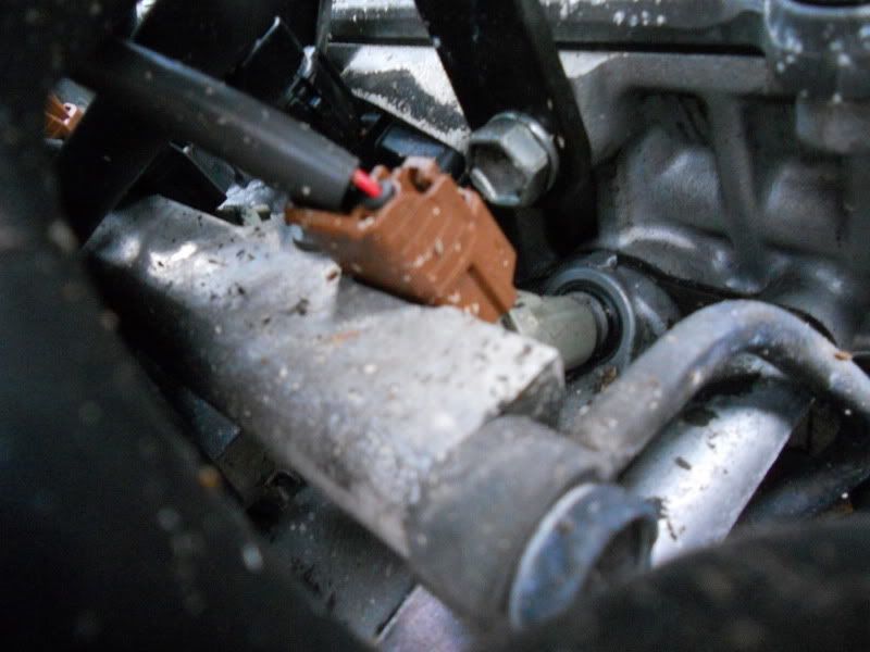

Another thing I need help with is the wiring.
Some of the body plugs are chopped off. So I've included some pictures of the plugs and wires.
If someone can give me a couple of pointers what are the wires in those plugs and in those bunch of wires ?

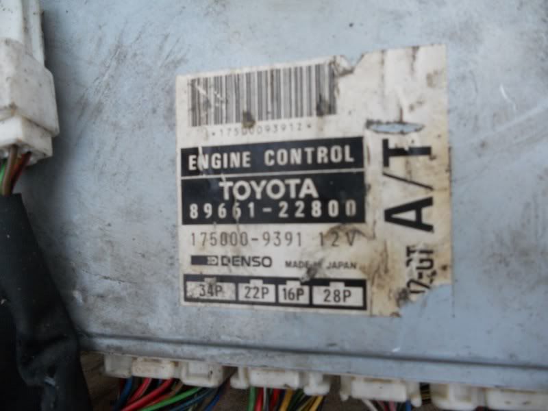

I'll buy it if you verify it is actually a 1jz head on a 2jz block. It is n/a? Looks like a n/a 2jz vvt-i engine.
Better pic of the ecu label?
No way that looks like a na vvt-i 2jz, clearly thats a vvt-i 1jzGTE

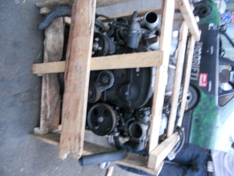

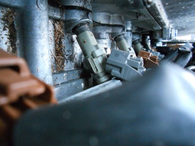

Here are some other pics of the motor. And yes, its turbo 1jz vvti head. Also it doesn't look like the conversion was made in home garage. Or the holes for the turbo oil feed drilled out.
All the bolts surfaces are intact, no orange/gray gasket glue on the gaskets. And etc.
I bought it for around 2k USD. Same price as Non VVti 2jz-gte go here for.
But there is limited supply here. 2JZ I could find were all in bad shape. And this one looked like in a very good nick.

the FFIM, ECU, valve covers, and spark plug cover all clearly indicate that the head is from a vvti 1J.. N/A vvti 2J head is totally different.
that ECU also appears to be from a JZX model.
