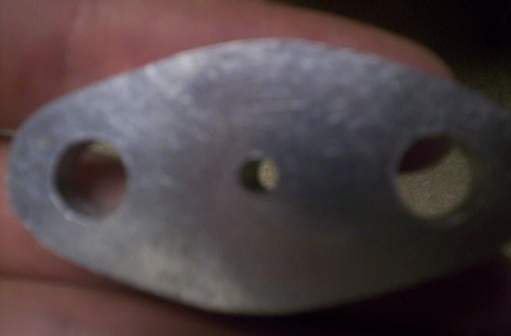

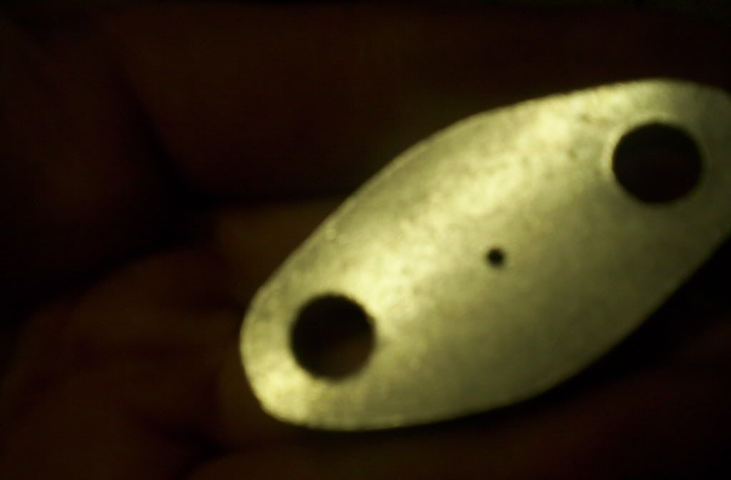

I got the -4an fitting from summit, I had to bore out the small hole in the feed flange to the turbo to a slightly larger one. Another question, since im running the -4 feed line on my gt45 setup, could the -4an cause it to over oil the turbo? I do have a -10an return.
tissimo
Stock is boring :(
4,238
Melbourne, FL
is the gt45 ball bearing? ball bearing turbos need less oil pressure/flow then a journal bearing turbo, thats why theres such a small hole in the flange.
If its a journal bearing then itll be fine. I ran a -4 without issues.

I need the answer to this also, as my oil feed flange has the same size hole; i have a 62-1...
