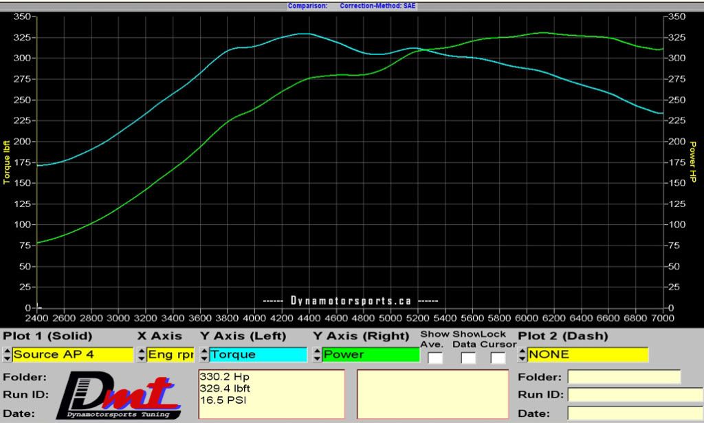

ok so here it is!! final numbers on STOCK 1jzgte twins!!!
1JZ GTE Stock block
Stock twin turbos
Custom intake, 3" exhaust
Front mount Intercooler, hard pipes 2.5" pipping
Walbro 255/lph Pump
Aeromotive fuel pressure regulator
-6an fuel lines
EBoost 2 boost controller
Aem digital gauges, Uego, Oil Pressure
EManage Ultimate with PNP harness
this dyno Vid was 303whp/309wtq... but not final numbers!!
1jz Toyota Pickup Dyno tunning at DMT - YouTube
here was the final dyno vid with the final numbers... 330whp/329wtq!!! @ 16.5psi
1JZToyotaPickupEMU.wmv - YouTube
