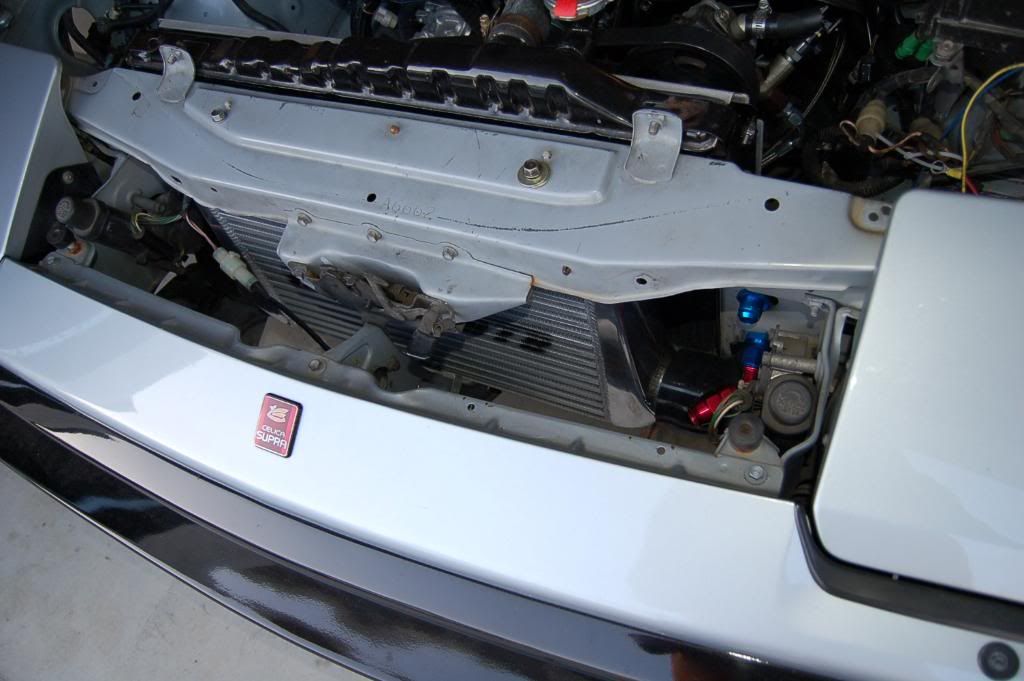

Here's a pic of my current intercooler, its a Mishimoto bar/plate, seems to work very well for dropping intake temps down, the measurement by touching the inlet and the outlets shows a big difference in temps. That part is good. The not so good is the placement and size of the intercooler covers up much of the radiator face. I mounted the intercooler in front of the radiator because I didn't want to put too much weight in the forward part of the car, for weight balance reasons. Yeah, I figured some airflow would be restricted but knowing that cars have the a/c condenser in front of radiators too, I thought it might be ok. Apparently not. From my readings, bar/plate intercoolers cool better than the tube/fin intercoolers, but also restrict airflow more (if you need airflow to continue to the radiator), they are also almost twice as heavy as a similar size tube/fin intercooler.
My intercooler piping is also kept very short with this location, as the piping enters the engine area on each side of the radiator, so a short distance up to the turbo, and to the TB.
Now I am going to try a tube/fin intercooler, about half the height of my present unit, so more air can get to the radiator, and maybe save about 10 lbs in the front of my car.
Whether the cooling capacity of a smaller intercooler will be ok for my needs, well that remains to be seen.
Crazy power is not essential for me, so if my boost must be limited to around 18 psi, that's ok I think.

6,625
Can't really put the intercooler too much more forward anyway, I would think. I would try a shorter height like you suggested you were doing. If nothing else, make some ducting to get air where you need it, fog light holes (well, fog light holes on the Mk3 area, never did figure out what was meant to go in those holes on the Mk2 since the fogs are in the grille) and some tubing could help you out.
I believe IJ put fans on his intercooler to help with the heat exchange issues he was having...
