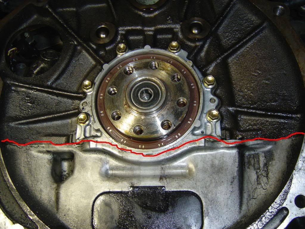

have you guys ever seen leakage from this sump area that I marked in red. I didn't touch anything in this area but from old age, maybe its leaking?

I haven't gotten my trans out and won't be able too until the weekend. I see in the pic above that it is definitely leaking from the seal, but I was wondering if anyone else has has leakage from the area that I marked.

I was able to look at the back of th valve covers and they are clean with no oil their. I will just remove the trans and see whats up It is definitely inside the bellhousing becuase I can see the oil in their when I removed the inspection plates.
