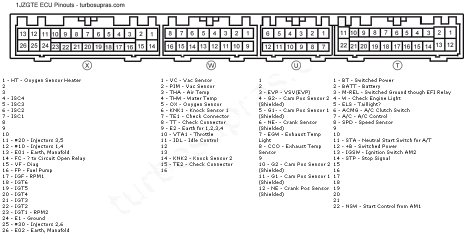

do you power (12v) at t1, t2, and t12 when the ignition switch is on the on position?

no i havent tried the pins on the ecu. yes i have opened the ecu and everything was fine. thats why i was so puzzled. the first thing i thought was blown caps on the board because i hear about it often on here and the firing command goes from the ecu to the igniter if im not mistaken.

if you do have 12v at those places then check crank angle sensor and the wiring to it and also check your grounds for the ecu and thats all i can think of right now

i worked on the car today and now my ignition switch took a dump the ecu is sometimes getting power to points t1,2, and 12. there is still not check engine light when the ignition is on the on position. is the ign. switch going to prevent the other things from working right?
Dr Tweak
If you have no solid check engine light with the key one, then there is one of four possibilities:
1. There is no power to the ECU on pins +B and IGSW
2. There is no ground for the ECU on pin E1 specifically
3. Your check engine light isn't working (ground the W pin at the ECU to check it)
4. Your ECU is bad (least likely).
ma70mkiii
Jul 16, 2007
139
ohio
well at first on pins t1 and 12 i had less than half a volt and 2.5-2.6 on t2. then i ran jumper wires to the ecu and all of a sudden it had a full 12v to all 3 pins and then it went back to same old. i determined the ign. sw. issue by tickling the starter. why would the voltage on the 3 "t" pins fluxuate?
