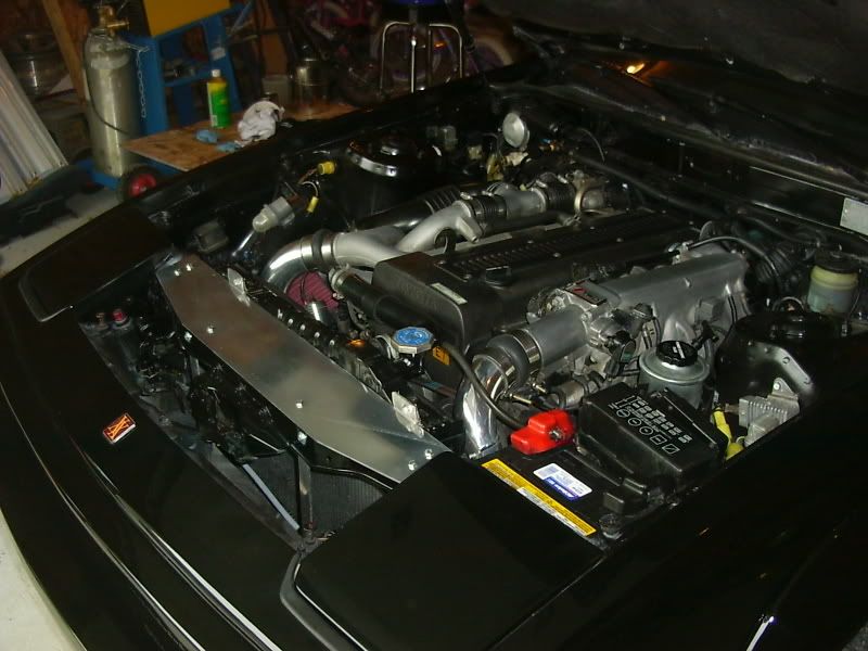

did you wire it up yourself?,
did you use an aristo or supra 1j engine set?

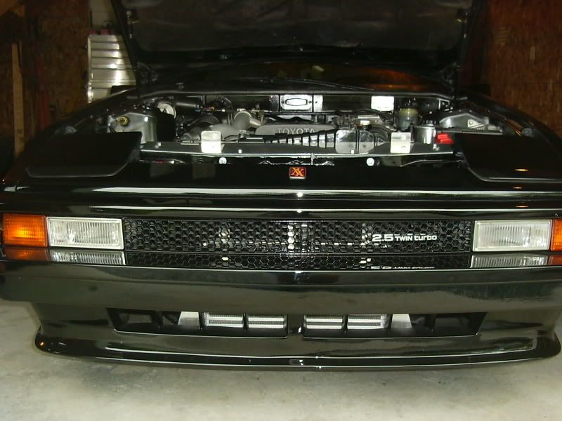

Thanks a lot guys i'm glad you like it !! It's very rewarding to finally see it starting and running so well :icon_bigg
Ma717mgte....it's from a 92 Jza70 with a R154 and yes I wired it but with some help from an electrical genius and info from this site and a couple others. Not a bad job took 6 hrs to get it wired and fired up. That first start was the second best sound I have ever heard !! ...I have a daughter so her birth was the only thing that tops it :love: 1JZ FTW !!!

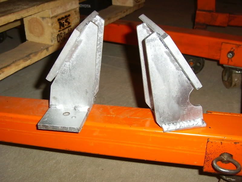

what did you use for mounts?
I could have made them with some effort but I went the easy route and got a set from Bonneville Automotive in Australia . Worth the time saved and they use the stock 5m rubber mounts. The tranny mount is from an auto MKII , fits the r154 perfect with no fooling around and adds the few inches required for the new tranny , the tunnel was another story that had to be pounded on for a while to make it fit :icon_bigg
Do you have any pics of the brackets, how much were they?. I have mk2 1jz project comming soon.

The mounts cost me $250.00 cdn to my door . They don't look like much but when you consider the time it takes to get the angles right and the height correct it's well worth it . Fit perfect and even have the cutout for the turbo return line . Heres the number and ask for Brian I had to add 011 to the number your location may require another 3 digit # but i'm not really sure just ask the operator if this doesn't work.. Good luck on your swap and I hope this helps !!
011-612-9553-4708 Bonneville Automotive

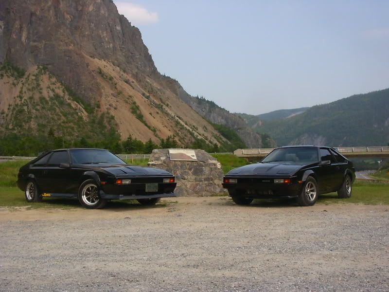

Had some company from Ontario over the weekend and took the a few pics so I thought I would share . Lil Devil and his lovely GF made the trip in his 82 7mgte !! We had a blast and the Toronto meet sure sounds good hope I can talk the wife into it !
