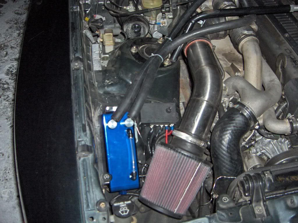

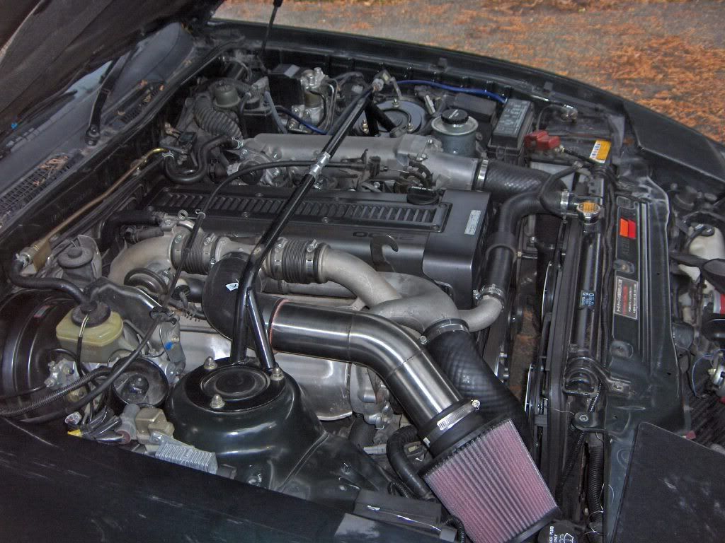

JustinGotA1j;1045590 said:
Here is the intake that Randy at BIC hooked me up with.
[THUMB]http://i205.photobucket.com/albums/bb132/JustinGotA1j/CC1.jpg[/THUMB]
[THUMB]http://i205.photobucket.com/albums/bb132/JustinGotA1j/HPIM1238.jpg[/THUMB]
I like this setup, about how much did that run you?
