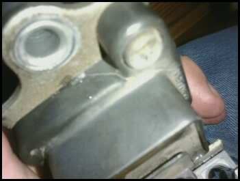

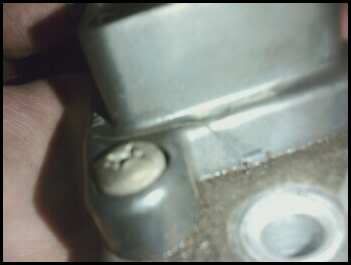

Pulled my coil packs:
Found a few cracks: (just snapped a pic w/ my cell of 2 of the cracks)
So basically I just take some epoxy and smear a thin coat over the cracks?

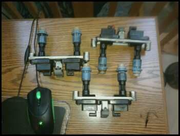

pictures fixed?
edit: also found another crack in the plastic under the rubber boot.
edit 2: make that 3 cracks under 3 of the boots.

yes they are fixed. not sure about the epoxy route on the coil pack, but my car was doing the same thing. gapped to .026 and loving it sorry I forget what speficially what plug I am running, but NGKs are the way to go.

Make sure you pull the blue boots off the bottoms of the coils, it is very common for cracks to form beneath them.

yeah i found 3 of them had cracks underneath the boots.
Thanks for everyones help! i hope this fixes it. The expoy is drying now.
