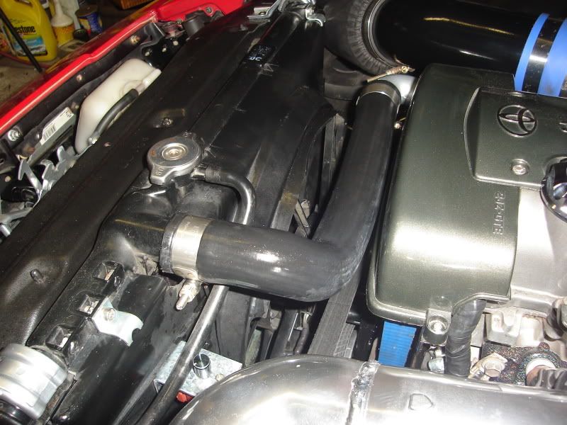

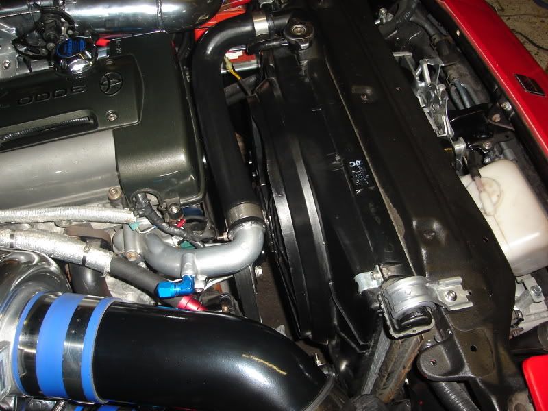

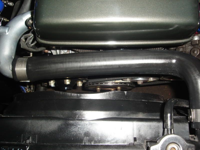

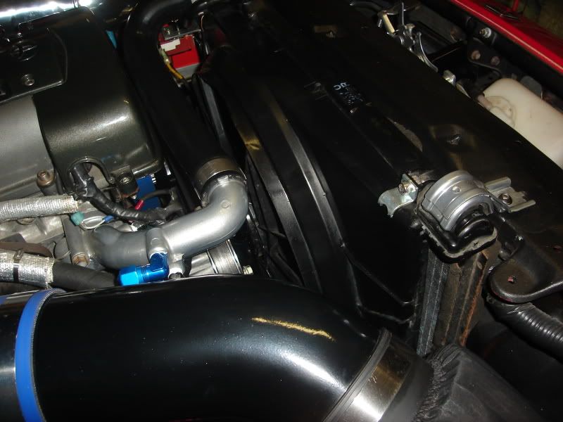

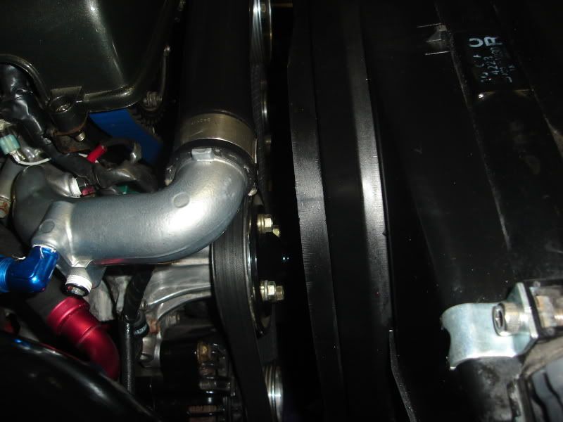

i'd like to see some pic's of the taurus fan's installed.i don't have much room in my engine bay.
some pic's of mine for referance

ya this is still my stock radiator:(.i need to get something better on there.the fan might need alot of trimming then though.
i think the thermostat is set good now.i went for a nice long ride and didn't kill the battery:)
