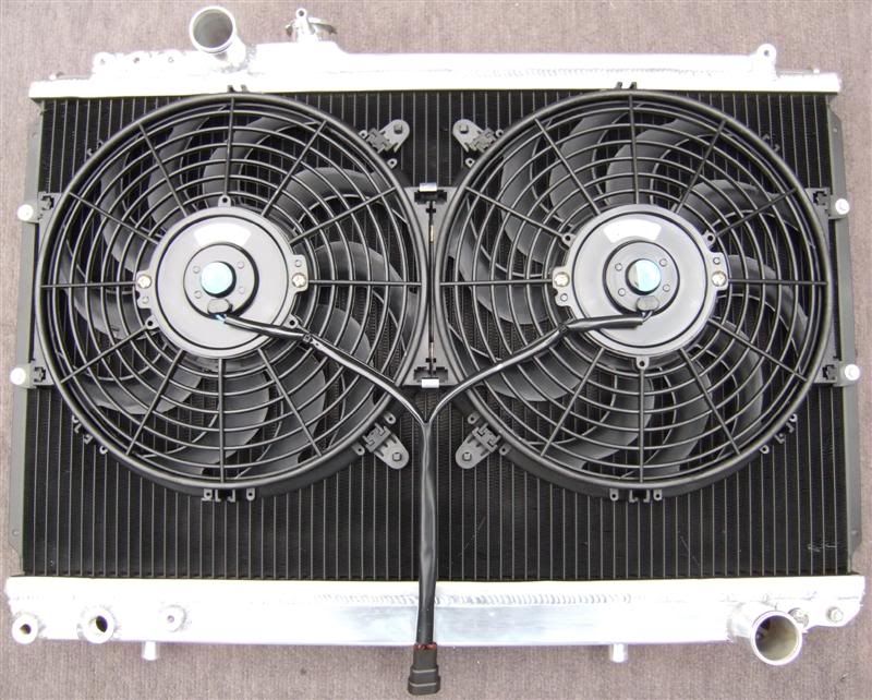

I have just written up this 2j pump mod & like yourself, I have a Koyo & that was causing fan installation issues.
I ended up getting a pair of individual 12" fans which fitted perfectly, with individual fans you have more options mounting wise such as putting them diagonal instead of next to each other.
Thread HERE
Fan setup:
I'll do another write up at some stage about how I control these fans. I managed to modify the stock hydrofan ECU to continue to switch them on & off as well as adding a second system that turns the fans on slow once the water temp gets to 40'C which provides the same constant cooling the hydro fan did as, this always spun round when the engine was running.
The fans were just generic fans from the net.

If you could I like to see how you modded the hydro fan controller to drive the new efans. That would make for a nice mod instead of wiring in a temp sensor and new relays to control the fans.

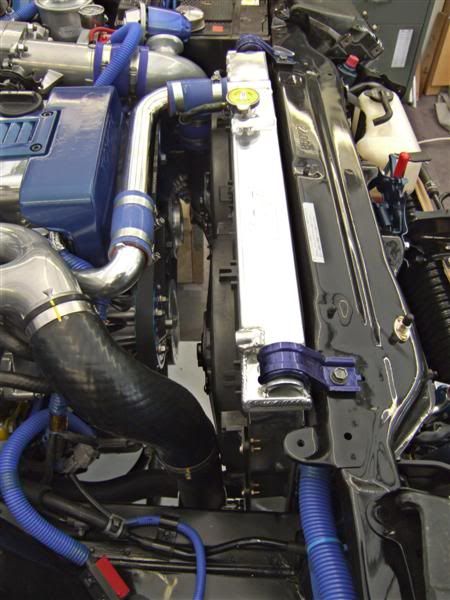

Well, the situation was tighter than I had expected. The driver's side IC piping is actually pinched by about 1/4" between the accessory belt & the fan shroud. Decided to give it up, get a single core Koyo rad & get rid of the dual core. I'll post that up for sale here once I have it out, cleaned up & get pics.

You should try and go back to hydrofan, its one of the best options out there by far. Fantastic performance and great clearance. I'm running 3" piping on my car with a koyo. From what I see, you need to redo at least part of your piping, the hard pipe from the throttle body to the part where it makes a 180 to the IC should be 1 piece. then the U bend to the IC another one. You have that coupler right by the AC compressor and its killing your clearance. I have attached some pics of how I did mine.
The fans shown in post 2 are great on clearance but I'm confident they wont come near the performance of what you had. Those fans don't cover near enough area to not have a shroud for the rest of the radiator.
Edit: going to a smaller radiator is a bad idea. There are plenty of ways to make it work. Redoing all of your IC piping would probably be the best/most correct route instead of getting a smaller radiator to make up for bad IC piping. Did your hydrofan start leaking? Plenty of ways to fix it, you can still get parts for it.
