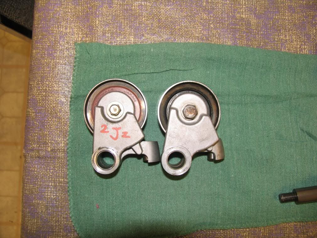

Here is a picture of the timing belt tensioner arm and roller. The Top one is 2jz and the lower one is 1jz. I set the rollers together and the middle together to show the difference in the arms.
1.5 jz's use the 2jz tesion arm and the grenade looking part is the same in all JZ engines. The arm sets the amount of tension to the timing belt. If you use the 2jz arm on a 1jz, it will stretch the timing belt.
I will make 1jz iddler arms for us 1jz guys and will try to make a 2jz one at a better price. I will talk to my machinist on monday about making some.

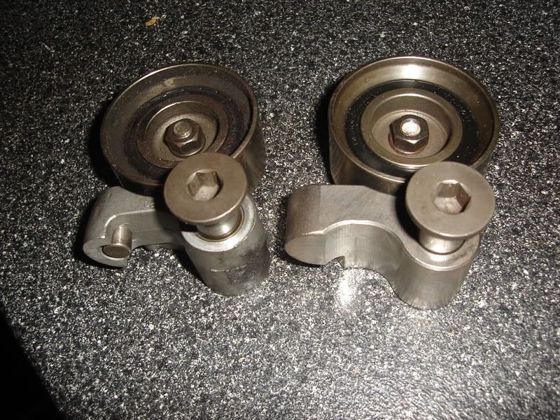

Here is a picture of the back.

So if i get this right i can use a new 1JZ or 2JZ timing belt roll and only the 1JZ tensioner arm because the 2JZ arent the same?

Correct. I bought a 2JZ idler pulley from Champion Toyota, that came with the 2JZ tensioner arm, and just swapped the pulley's to keep the original length arm, because the arms ARE different, and the pulley's are the same.

The 1JZ & 2JZ idlers are diffrent! I know this for fact because I snapped the idler on my 1JZ in half!
I ordered the 2JZ one the only way to get a 2JZ idler to work is by grinding it down a little and then it will work fine.
There is an adjustment screw on the outside bottom of your motor if you grind a little bit to much off you can still adjust it.
but with the 2JZ idler in your car it pushes on the belt to hard.
It will not fit with out some minor modification.
Just set the 2 side by side and you will see how the 2JZ one sets taller and further into the engine.
Its verry easy to compair the two and figure out what little you need to grind so that the stance is the same. After this modification it works perfect and with no flaw!

The tensioner arm are diffrent i know, look on the first page. 2JZ are longer, but the idler wheel are the same size and sould fit. But what i wonder was the timing belt tensioner, but know i have order it so i will see if it fits :)
