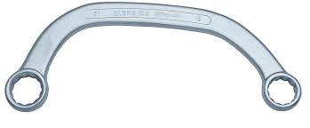

Good Idea, I will be doing this the next time I remove them. I ended up getting some obstruction wrenches from Harbor Freight
images
Made it super easy. Took about and hour with the info in the right up and the wrenches.

Someone made a wrench like that on purpose? Haha, that's pretty awesome, bet they come in handy!

i have a set of those but didn't work for me to remove that one bolt... there wasn't enough clearance to fit the wrench on the nut... i had to remove the rear manifold. maybe your tools are skinnier mine are fattys. either way glad you got it off.

^ I took the waste gate off of the rear turbo,and the vac connection off of the intake housing to get room for my hand I also had to come in from between the turbos. Next time I will be pulling the motor . I need to do the clutch, retap the bolt holes for the return y pipe, and find some seepage I am having. I end up with about a tablespoon of oil on the ground overnight. So it isn't serious, but it is annoying.
