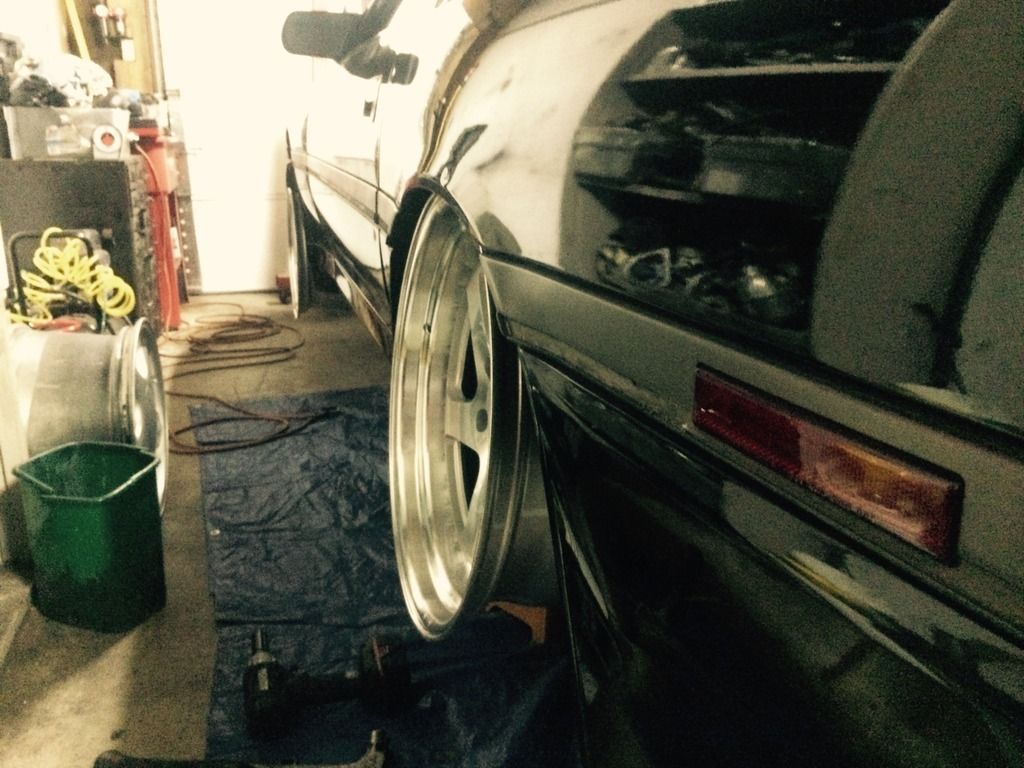

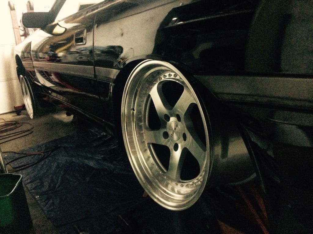

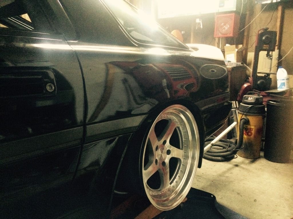

Cruising ebay for cheap wheels, i came across a new set of 18x9.5 / 18.10.5 + 22 wheels for $500 shipped. The vendor didn't list an actual photo of the wheels, just a computer drawing with a blank center cap. The listing didn't even show the brand. The wheel design is not my favorite but the size and offset for the price was irresistible. Found out they are ZEDD wheels when they were delivered. I was alittle concerned about the rear fitting because the 18x10 +24 rears on my friend's supra are a close fit. I must have slightly pulled the rear when I used the fender roller tool. The rears tuck nicely.
Seeing the wheels on the car made me more happy with the purchase. Best fitting cheap wheel I've bought so far.

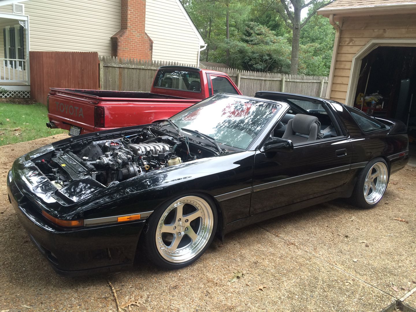

No big update. The summer heat killed any motivation to work on the supra. The past week's weather had been pretty comfortable so I put in a little work. Painted and installed the rear three piece spoiler, installed coilovers and wrapped the wheels in tires. 255/35/18 front (9.5" wheel) and 265/35/18 rear 910.5" wheel).
Will finish up the wiring soon.

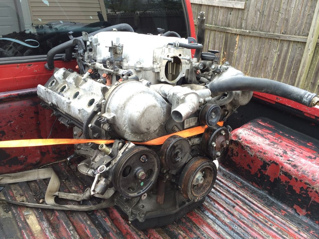

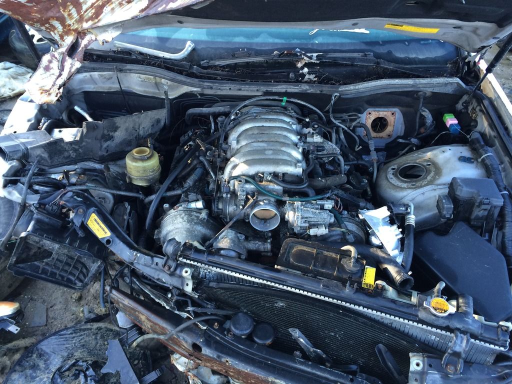

Project is still going on. The end of 2015 was pretty good as 1uz VVTi motors were falling out of the sky into our local pick n pulls. They would typical end up like this one we found.
Front end collisions. People are destroying these cars by running into crap. This is one of the five V8 VVTi motors we pulled this fall and winter. I pulled this one last weekend to use as a backup motor.

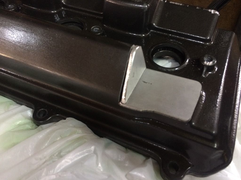

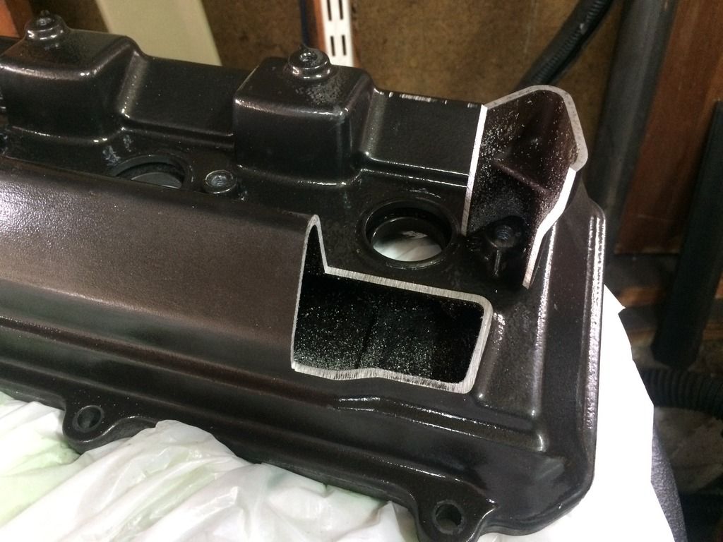

Found out that even with the smaller Tacoma brake booster, The larger VVTi valve cover will not clear it. I had to trim the cover and fab up plates to weld over the opening.

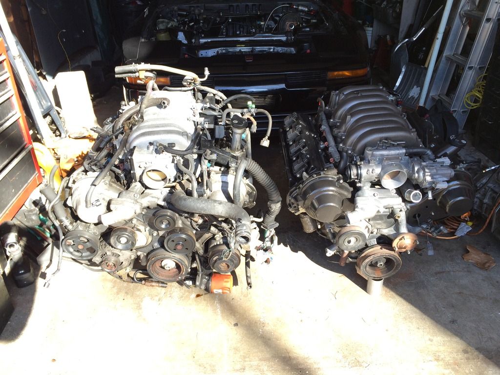

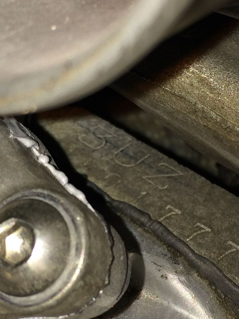

Then I came across a a guy parting out a 2003 LS430 on craigslist. I picked up the 4.3 for $500. Pulled the 4.0 from the supra to swap over the valve covers, timing covers and intake/throttle body.

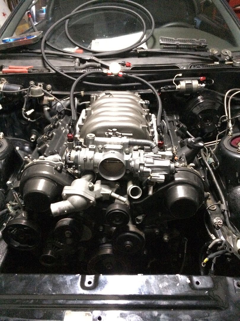

Dropped the 4.3 into the supra and learned how to make AN lines.
Also installed a corvette fuel filter that has a built in pressure regulator. This will over come the issue of the returnless fuel rail on the VVTi motor. I need to modify a couple of my fuel lines and then I'll start it this weekend. I'll run the 4.3 on the 4.0 harness, coilpacks, throttlebody and ECU. This will eliminate the complexity of installing a drive by wire accelerator pedal.
