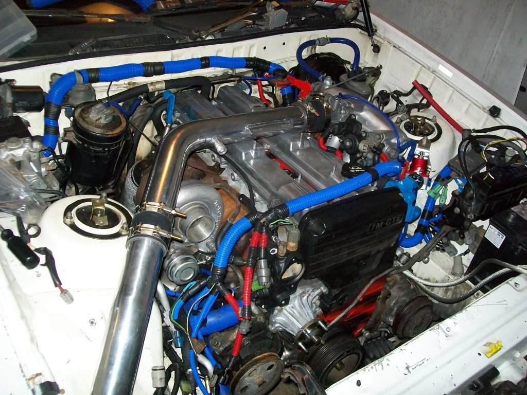

Today!
Been spending some time cleaning up more of the wiring harness on the passenger side (Drivers side, for you), so off came the ignitor, the injector resistor pack and the relay. The bodywork was cleaned with a toothbrush and some kerosene, then wiped clean with a soapy sponge. Came up nice - although the paint underneath is in poor condition. The amount of accumulated gunk all over the engine bay surprises me. The blue one i have is OLDER than mine by 3 months, but it's in MUCH tidier shape. Oh well.
Anyway - like i said, i've already done the coil pack wiring, although i have a feeling that sooner or later, i'm going to need to pull the entire engine bay wiring loom and start from scratch. It's a temporary fix. The parts that came off were treated to a nice brush with kerosene and paper towels. Everything came up a treat. You can now even see the colour of the wires! *feigns shock*
The bracket that the resistor pack and the turbo pressure sender mount to came off, got scrubbed, lightly sanded to key it and given a good going over with the primer. For now, it's looking a million times cleaner, but eventually, i'll get out the can of 3E5 and do them body coloured, with a clearcoat. However, that day will be when the engine bay wiring loom gets re-done!
Here's a picture of how the bay looks now:
And a closeup of the cleaned up wiring & brackets:
And of course, as a special treat for you lot - a video!
[video=youtube;TlFzOxVFX9Y]http://www.youtube.com/watch?v=TlFzOxVFX9Y[/video]
Comments? Ideas? :)
