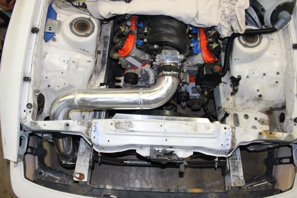

tucked radiator, griffin 24x19x3 with custom core support and removable upper
more to come soon

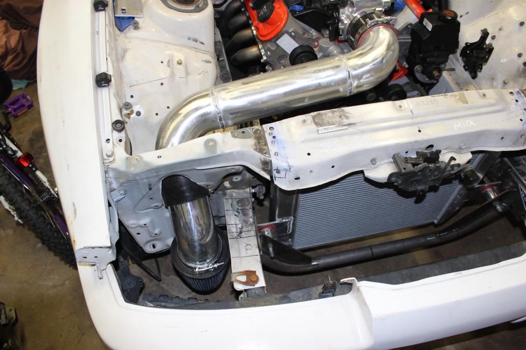

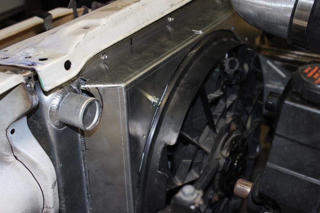

yesterday I was able to fab an aluminum fan shroud with a two speed Taurus fan. even with a tucked radiator it eats up a lot of real estate. also almost done with the cold air intake. Im trying to create a sealed socket joint since i want to have the filter housing bolted in and i don't have room for the coupler and clamps.

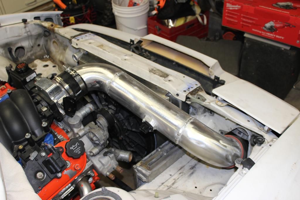

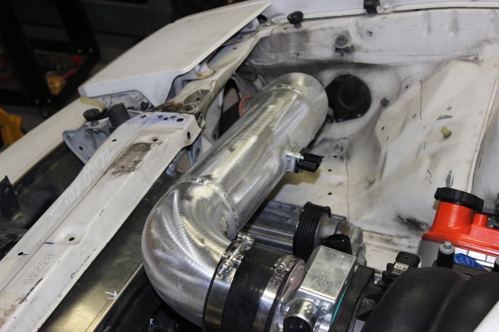

some work from the weekend
aluminum radiator shroud and i managed to squeeze in a 2 speed taurus radiator. I will use some foam gasketing to seal it later. Also I built my 4" intake under the head light. I will eventually build a
an airbox to house the filter element. I am using a LS3 cartridge maf instead of the ls1/6 style inline maf sensor. I built a slip/socket joint so that i can have a good seal with out having to use hose clamps for the piping that connects to the filter housing. It is covered by the intake hose at the moment. Bon Appetite enjoy.
