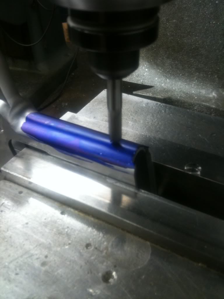

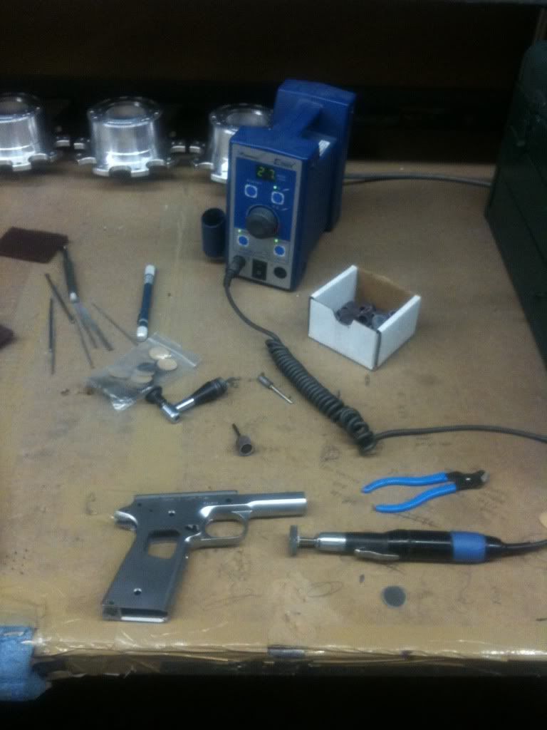

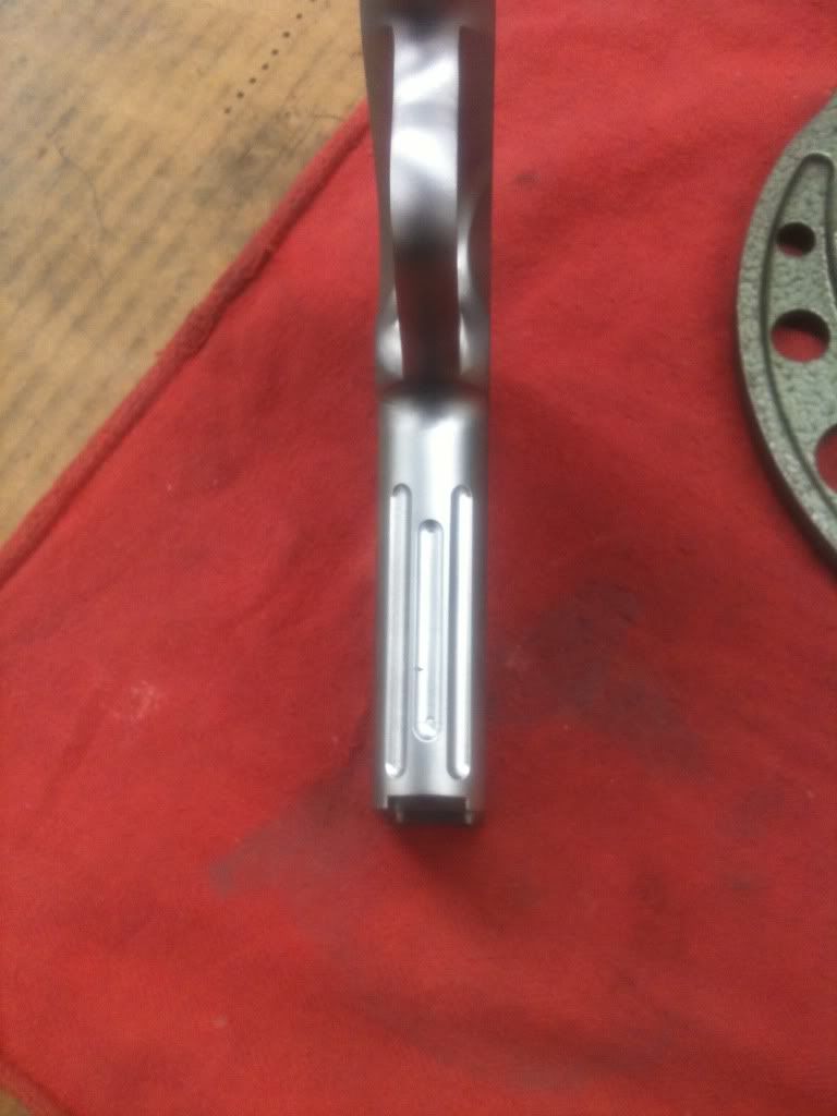

This is my 1911 I've been working on...
This will be a full size government.
