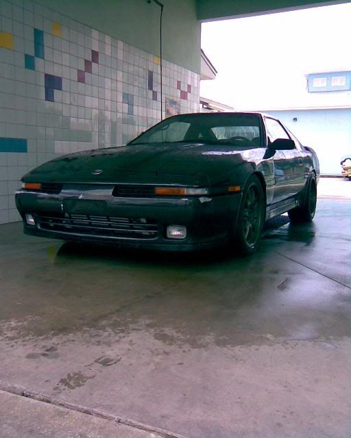

18x8 +32 and 18x10 +35 245/40s and 275/35s Slightly rolled front, no problems and stock rears.. its pretty low on hks coilovers.
only pic I have with crappy camera phone

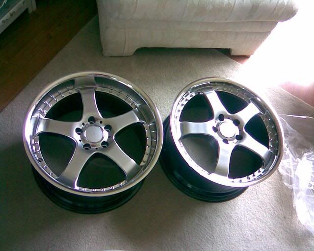

recently just got some 18x8.5 +38s and 18x10 +35s for my blue 91.. not installed though.. will sit the same as above on the car
I like to show them off ;)

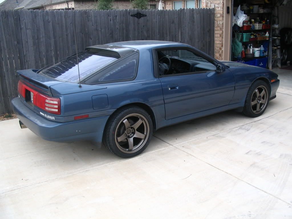

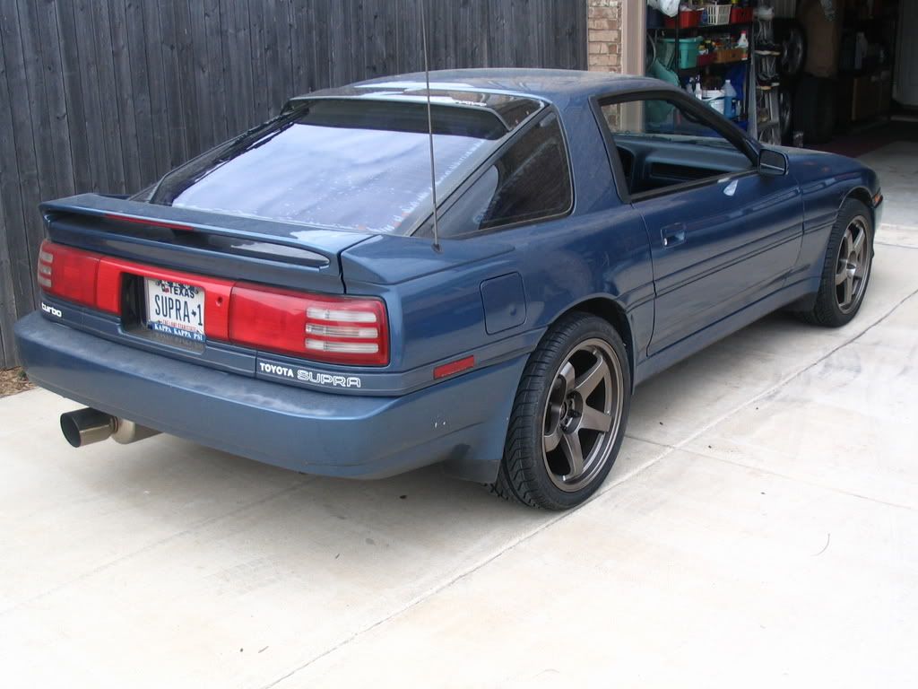

18x9 on the front and 18x10 on the back with 265/35s.....sorry for crappie camera angle i'll try to find another pic
dude your tucking 10s what is the offset and any fender mods
