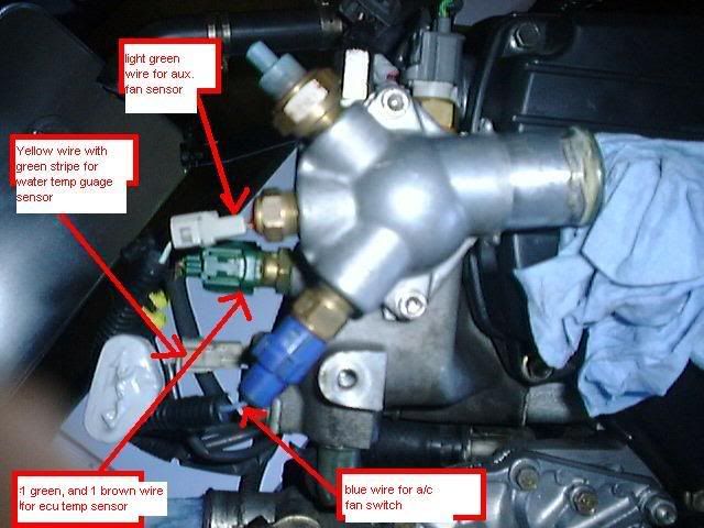

As per this picture I do not have the "1 green and 1 brown wire for the ecu temp sensor" plug on my harness. My guess is this is why it's running like crap. I have the other single wire, the yellow with green strip. Any way I can hardwire it into the ecu? Where would I find that plug at to run my own wires from it?? I have a field harness for my VPC so it wouldn't be a problem tapping into it. Let me know what you guys think!
-Chris
edit: Nevermind, the sensor I had was on a JDM motor's water neck. I had the correct plug. I just switched the plugs from that to my usdm motor, cleared the code, and started it up and it does the same thing. Except it doesn't stutter when you hit the gas now, it revs freely. And I guess it doesn't smell as rich at all, but it still smokes and my wideband jumps over to 10:1 after about 10 seconds. Think there could be something wrong with the UEGO?
