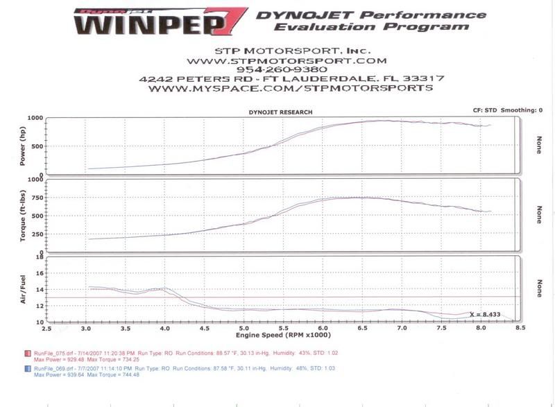

I had two dynos that Could show you the difference but i can only find one. this is my personal friends 1.5jz
He made 923 and 750 foot lbs of Tq. and not only that but at 3000 rpms he made over 200 foot lbs. and this was on c16 not e85 which everyone knows e85 will increase TQ. You will NOT find a full 2jz making low 900's with 750 tq on c16. the 1jz head creates Monster TQ and spool! just so you know he currently makes 949 and 800 foot lbs of tq on e85 and about 230 tq @3k rpms
2jz head flow= more hp
1jz FAST flow = more tq all over the place
Btw this dyno was 4 years ago. and not with a Fancy Billet super aerodynamic modern day Turbo.

Holy crap man, the numbers (and revving, wow) seem right for a 1j, but damn... did he dyno in 2nd gear?

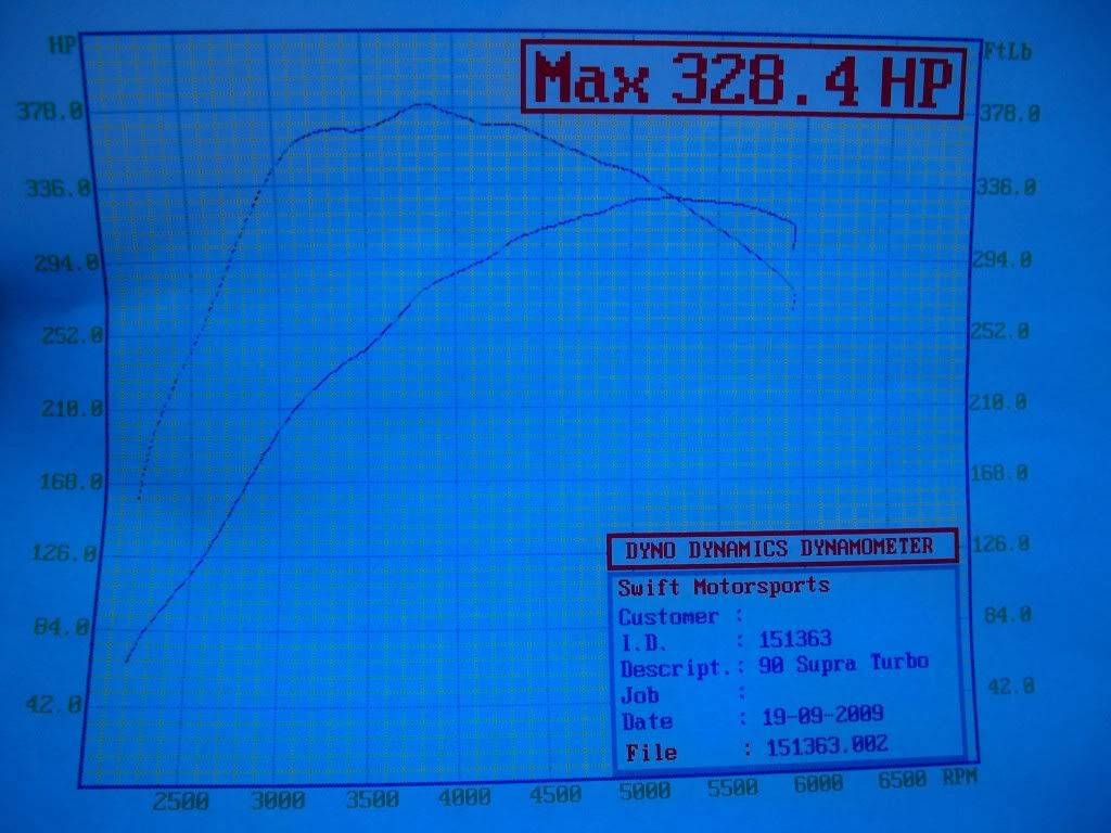

this is my old stock 1jz. stock twins stock boost

there is something about that graph above that makes me highly doubt the possibility of that being from a 1J, let alone stock twins.

That looks exactly like what he says, but with a FMIC, 3" dp/exhaust and a cai system for the twins and a safc. there is nothing irregular about that graph.
